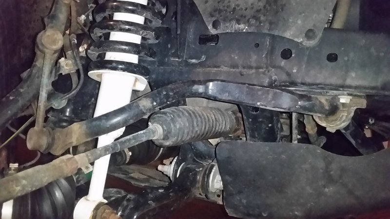

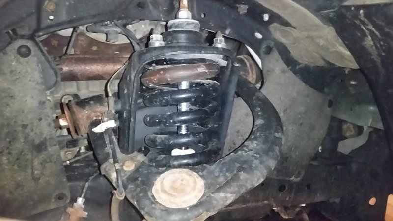

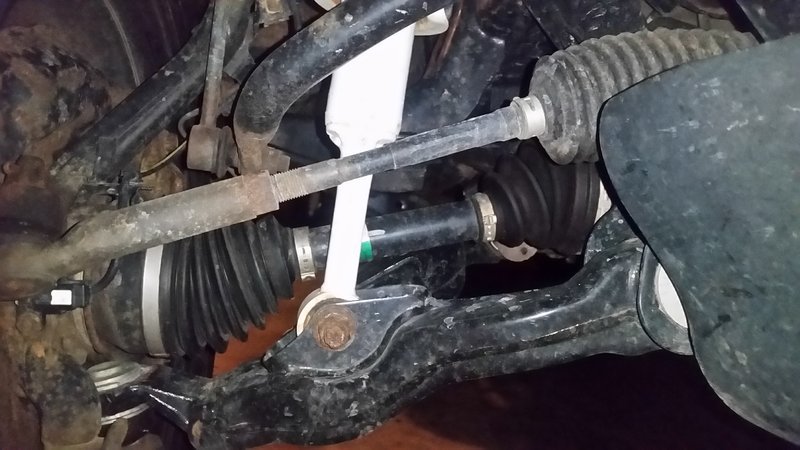

    Look at the photo of the shock that shows the lower part of the spring (#3) - I think the lower spring seat is installed upside down :facepalm:That would explain the extra inch of lift.

    That's my first suspicion as others have commented. Don't know if the lower spring seat is removable on these? Have seen it on the bilstein and when installed improperly you can see the clip the seat sits on. Maybe just take 1 of yours off and put it on you friends truck drive around a little and see what it does on his. A little investment in that time might answer a lot of questions.

    The spring seat is not removable

    The lower spring seats weren't removable on these, so they can't be upside down
