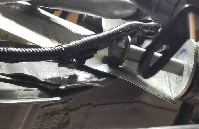

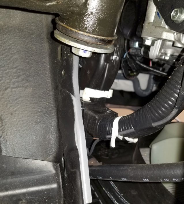

    Either you get lucky or I got unlucky.. lets just say there is a range of experiences for UCA bolts.
    Mine were ramming into the body sheet metal that supports the battery area even after that thin fender sheet metal was bent out. Passenger side was about the same fun.

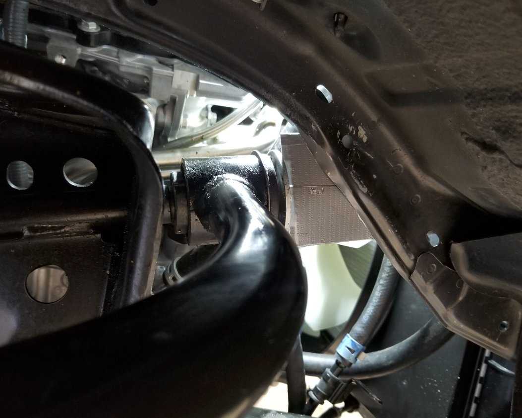

    Just be ready in case you get a fight. Cut off a little piece of sheet metal and duck tape the back side, helps the bolt flange slide a little better. Have a wooden dowel also, cut into several different lengths. That is the only way I could beat those damn things out.. and back in, one millimeter at a time. Actually a crow bar on the passenger side was the trick, only thing heavy and skinny enough to swing without smashing the tubing around it. I think it was like 45min each coming out and at least as long going back in, with some figuring shit out time to get the right combination of things listed above to get them moving as they hung up a lot.

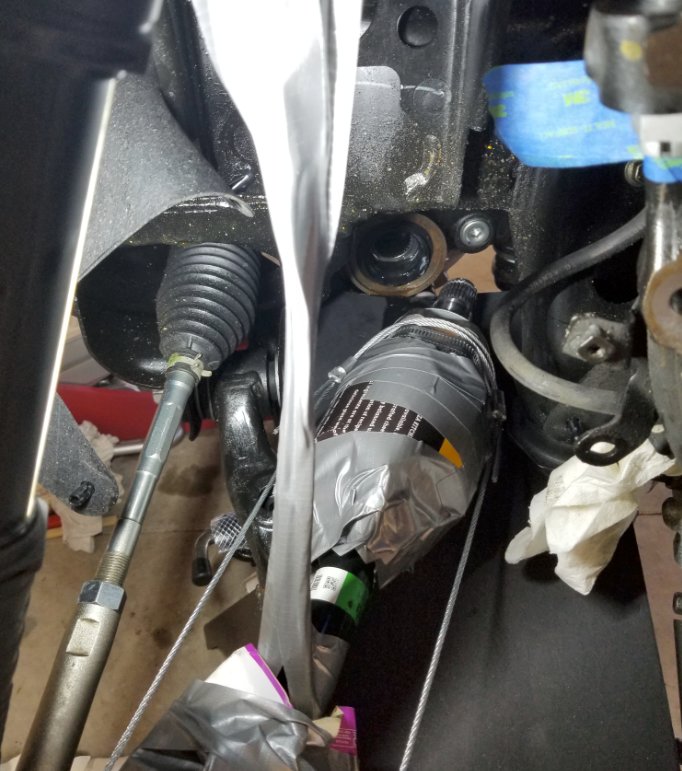

    PS. use the cable with 2 chokers on the end trick for the CV axle, loop the middle through a shackle and drop that on the handle of a good 3lb+ hammer. Then swing away, about 1 minute vs beating on it awkwardly while laying under the truck forever with no progress. (just stop swinging once it pops out a little)
