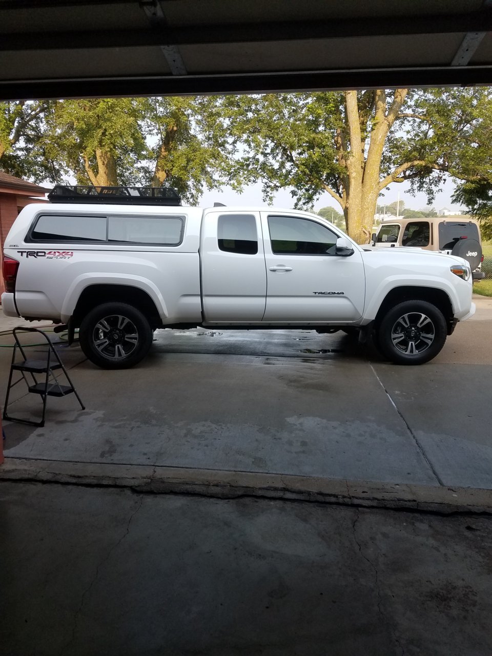

    The OME kit on my wifes 2013 rides and drives fine even with the caster being ever so slightly out on the front passenger side. OME heavy springs and shocks.
    Your alignment may come into specification without anything additional.
    I went this route because I could order the front end pieces assembled and did the installation myself. Plus pretty economical.
    I wonder now if after 4 years and 40k miles if the alignment specs could be achieved now..after the time and settle of spring.
    At minimum you'll want something for the rear. I did progressive 3 leaf on my 2017 and it carries 400 lbs or so very well.

    Optical illusion a little with the driveway crack but it still sits higher in the rear. About like factory before adding weight.20210809_083341.jpg
