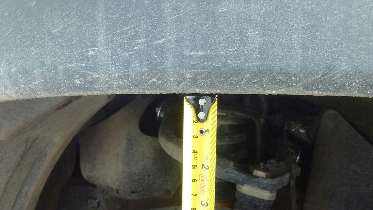

    I thought this thread would be a good way for people to see what you really get for your money. Share what you've got after you've well and settled. For example I put my kit in 5 months ago, please don't share what you got after 3 days. Also please don't clutter the thread with questions about tires, vibration etc, plenty or other threads for that. A hub center to fender is an equal measure to all who haven't trimmed.
    Edit: To take this measurement hold the tape measure against the bottom of your fender lip. Let it hang straight down, get down on you knees and eyeball the center of your rim. This style of measuring takes away the differences in tire size and tire pressure between vehicles caused by measuring from the ground up.
    Double cab Off Road
    OME 888 on 90021 with trim packer on driver's side
    Standard duty Dakars (new style)
    Pelfreybilt bolt on sliders, 1/2 tank of gas, no excessive weight in it and I haven't flogged it off road (yet).
    Settled height hub center to fender bottom
    DF 22 1/2"
    PF 22 5/8"
    DR 23 1/2"
    PR 23 1/2"
    On another note I loaded 150lbs on my front bumper and bounced it around a bit, came down 1/4" on both sides.
    Edit: The average 16+ stock Tacoma is 21 inches in the front and 22 inches in the rear from what I've read on here. Those stock height numbers do vary quite a bit, seems a lot of double cabs are 1/2" lower
