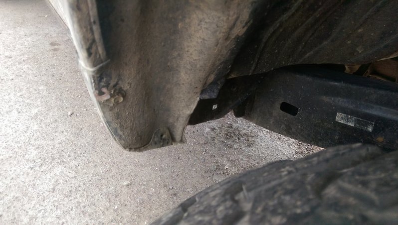

    These are the pinch welds, right? I have modified them with a hammer... Truck in question has been rolled twice and has a cage and a soft top. Hammer mods have long since been used. Lol.
