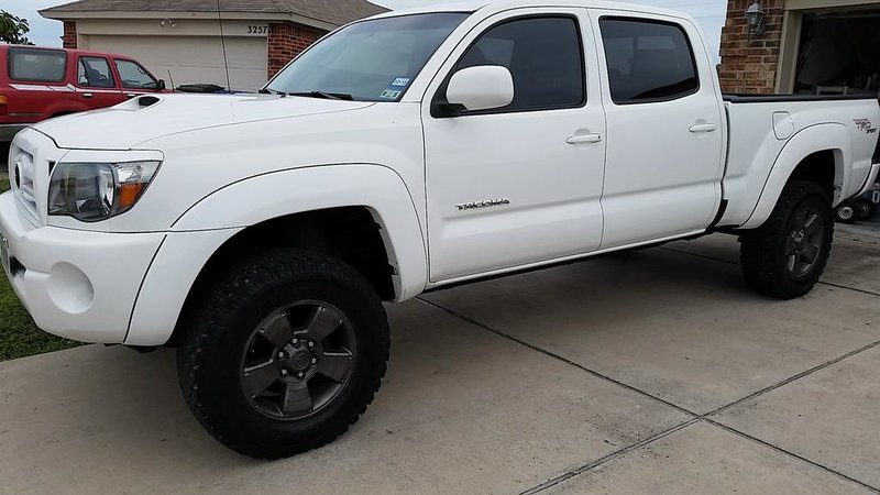

    Hello. I have a 2009 TRD 4 dr.long box and added a 3" lift from Supreme Suspentions.Under 200.
    3" front spacers and 2"rear blocks.I love it. I did install it myself with the right tools and floor jack, jack stands and a half a days work. I did also paint my rims. i'm running BFGoodrich AT 265's. The ride is fine. No vibration. Make sure to get a alinement and use Lock tight.

    Yes sir

    Hey. If you have the money replace the parts for a better lift.
    LOL. I have a master that watches what I spend on my Taco.

    Thanks for the great advice! Great looking truck!
