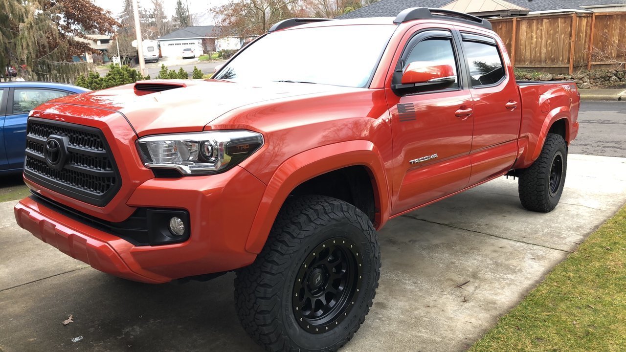

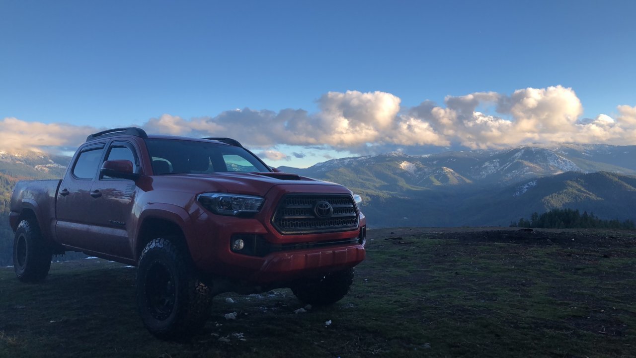

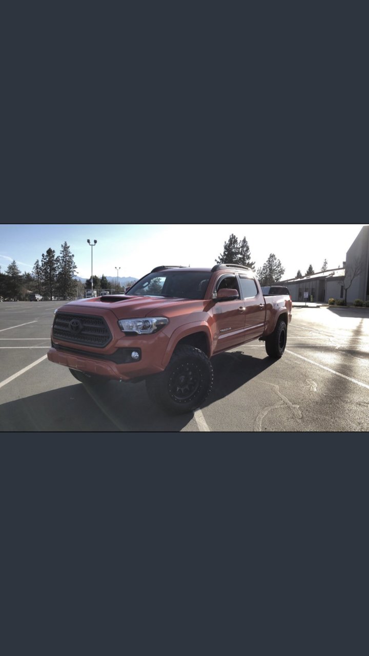

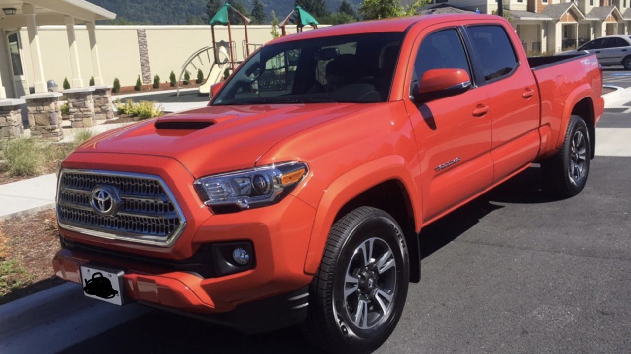

  8. Jun 24, 2018 at 5:56 PM
    #28
    Rustytaco71
    Rustytaco71 Well-Known Member
    Sep 13, 2017
    #229894
    2,140
    John
    2018 4Runner
    I did a 1” lift on mine and the difference was DEFINITELY noticeable. Sometimes it looks like it’s more than 1” too. I’ve had mine for about 10k miles now, zero issues.
    The before and after picture are a little crappy, but I don’t have a lot of before pictures. First picture is the day it rolled off the lot, to some recent pictures. Kind of hard me to believe it’s the same truck sometimes, and how much better it looks now:D
    doorsidedown and Tig3r_Bit[OP] like this.

  12. Jun 24, 2018 at 9:35 PM
    #32
    Rustytaco71
    Sep 13, 2017
    #229894
    2,140
    John
    2018 4Runner
    1” all around, Bilstein 5100’s on all four corners with stock coils upfront. Front shocks were set at the 3rd notch (1.1”) and I first had a block in the rear but have recently switched to an AAL which gave me a stiffer ride. The ride with the block was a little too bouncy and it would sag too much when loaded with 300+lbs of cargo in the bed. One thing I do plan on doing is changing the coils up front. When I have a full loaded truck it sags quite a bit to where my tires rub at ~85% turn. Then I run into the issue of the coils lifting too much which I don’t want because I don’t want all the issues that come with altering the dynamics of the truck by 2”. It’s a win-lose situation - first world problems.
    EDIT: Heres a picture I took this afternoon after cleaning her up.

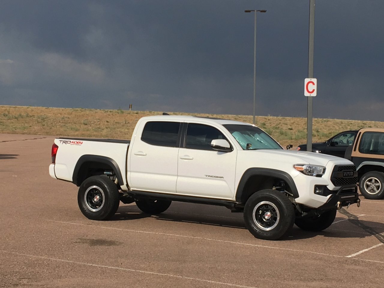

  15. Jun 25, 2018 at 8:35 AM
    #35
    CoastieRon
    CoastieRon Hammocking Fool
    Jan 1, 2018
    #239946
    2,431
    Ron
    Nashua
    Lil' Silver
    Too much.
    I did the following:
    3rd Gen 5100s all around
    OME 884 springs
    HS 1/4" spacer on the driver front for lean mitigation
    Rogue 1-1/2" AAL
    All the final measurements I got before settle and pictures can be found here:
    https://www.tacomaworld.com/threads...idiocy-journal-bs.527020/page-7#post-18094553
    It rides fantastic.
    Tig3r_Bit[QUOTED][OP] likes this.
