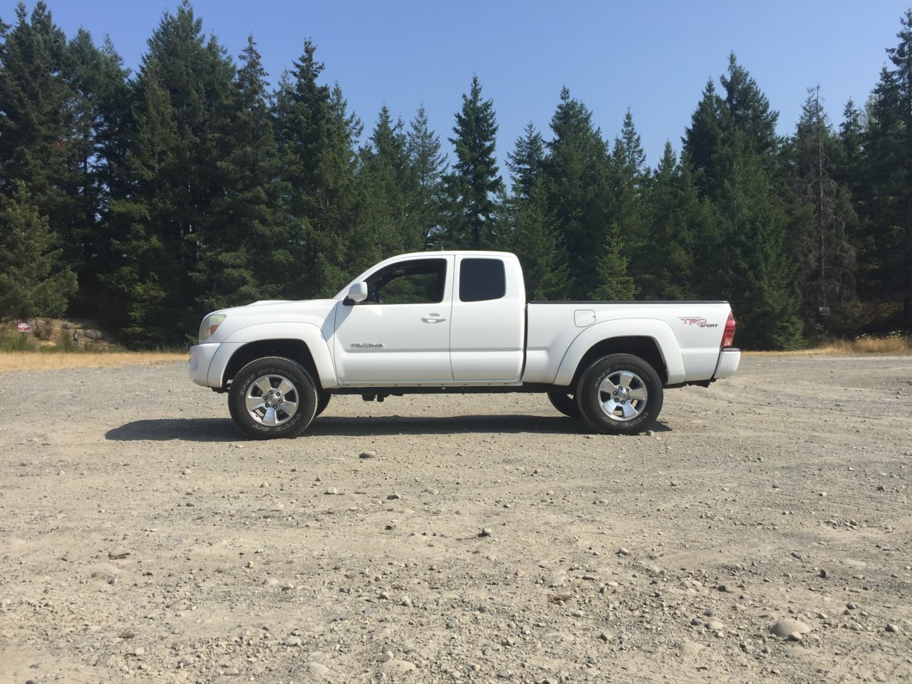

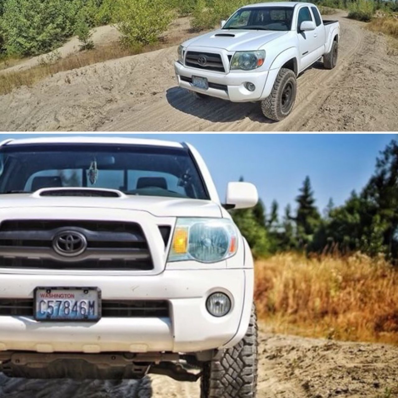

    Not to seem rude, but if you navigate to the suspension section of the site you can read up on many people asking the same question.
    The best bang for your buck “leveling kit” is Bilstein 5100 ride height adjustable shocks. They allow you to raise your front end easily and affordable. Also, they perform decent on/off road.
    If you want to lift more than 1” or so in front, you will need a way to lift the rear as well. I would just stick with raising the front either .85” or 1.75”. You can fit 265/75/16 (approx. 32”) tires no problem.
    IMO, there’s no need to go bigger unless it’s just for looks or serious off reading that is outside of a “high school budget”.
    There’s my in-depth answer. Everyone please copy and paste for every other high school budgeter that wants to jack up their taco.
