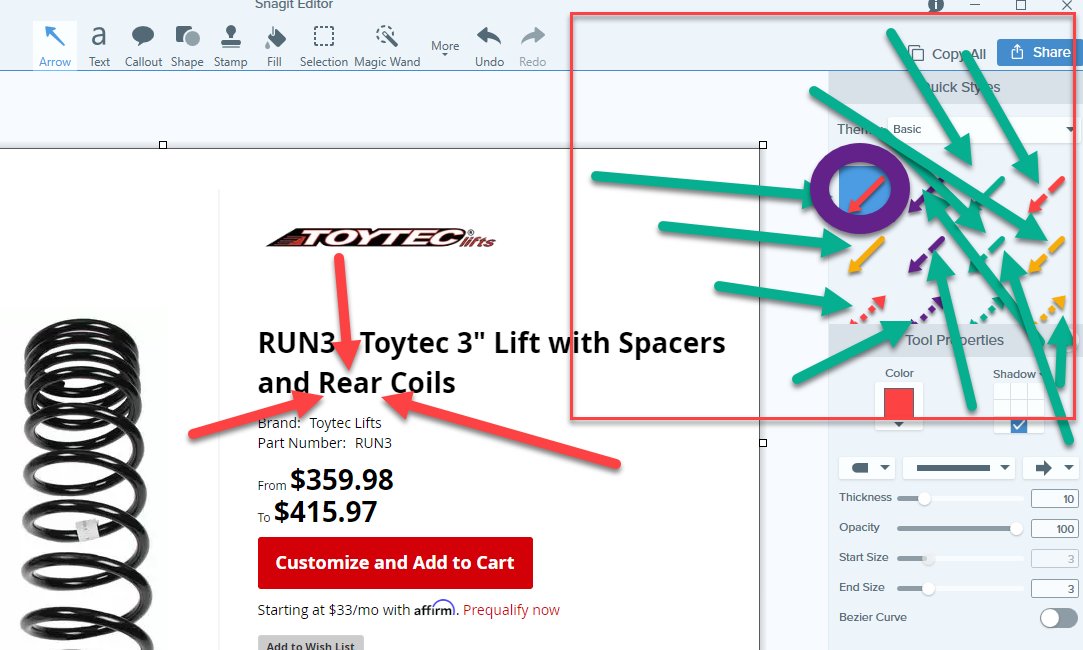

    For street use, or MILD/EASY offroad stuff, a drop bracket lift is fine. BUT, you will be permanently altering your frame. A 2-3 inch suspension lift can be installed in a couple hours in a driveway, and taken back out and your truck be stock again just as fast. But once you cut a piece of your frame out, there is no going back without expensive repairs to your frame. This can also hurt resale, depending on who is interested in buying the truck.
    Could you share a couple pics you've found online to show us what look you are going for?

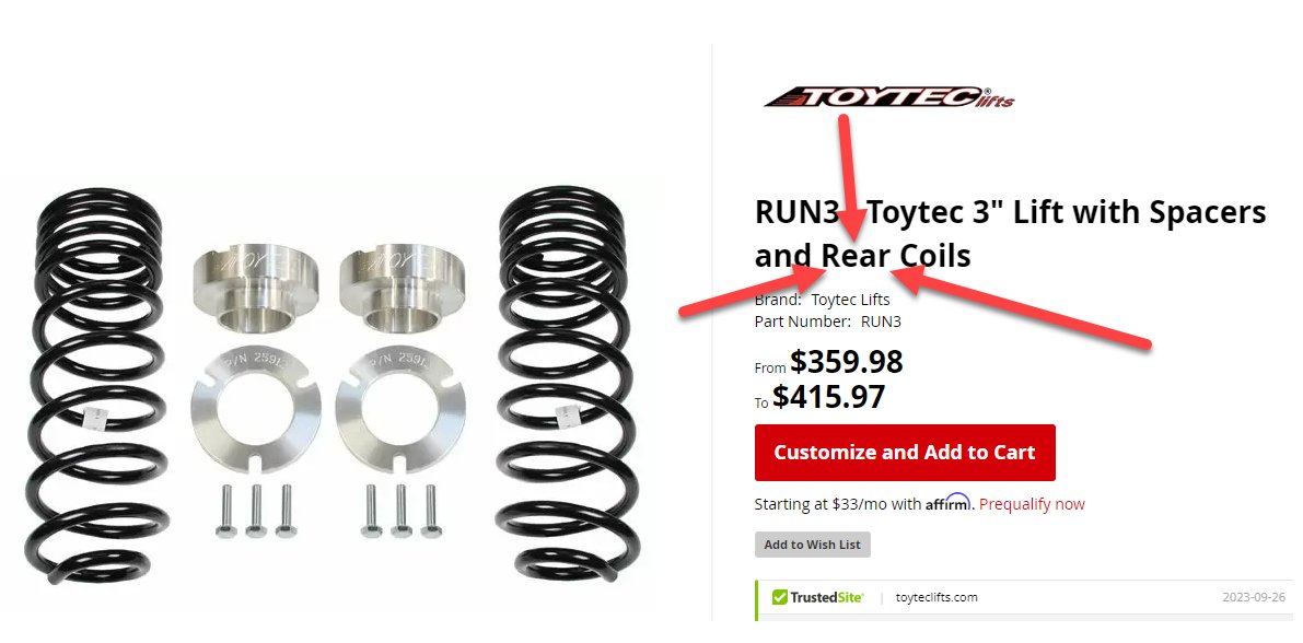

    I bought mine and had the dealer do a Toytec 3inch spacer/coil kit. Along with having them add TRD wheels and KO2 tires. Truck sits tall enough for me and stance is very mild, yet aggressive. For comparison, my buddies 3rd gen is lifted with Rough Country "3inch" kit and same spec tire K02, and my truck sits slightly higher than his (not quite 1/4 inch from fender to ground) Link to kit dealer put in:

    LOL

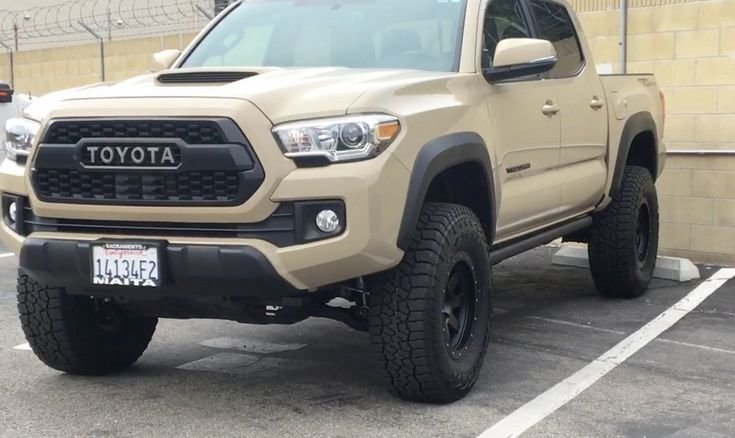

    Is this a good image for you to see what I am thinking height wise/ look? (I don't care if it is level.)

    If that's what you're going for, use the $800 to get some spacers and blocks

    You should be able to do that with a spacer lift like that ToyTec kit someone posted above. You'll also need a block for the rear suspension, but those are cheap.
    Just note that pushing your front suspension to 3 inches or more of lift causes your CV axles to be at a very steep angle, and will cause them to wear out much more quickly.

    The difference is the picture of the truck you posted is basically just leveled and that look is achievable with the cheaper spacer/block combination. This leaves you some funds to put towards wheels and tires.

    That's a lot of arrows

    Plenty more where that came from!! got boxes and circles available too!
