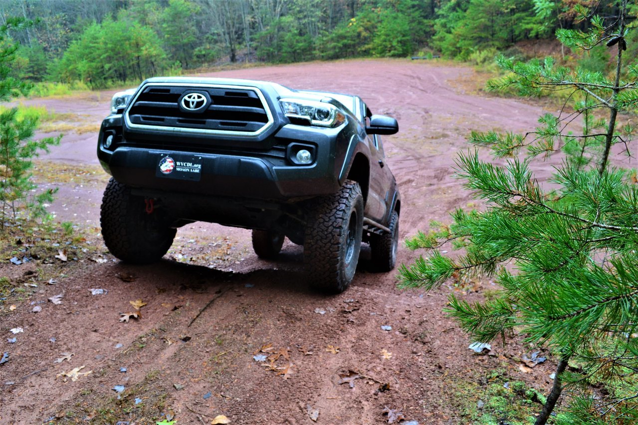

    I am looking for input on lift kits from people that have lifted there 2016 aclb 4cyl Tacoma.Weekend warrior, have a set of beefy sliders on now, after a lift I plan on going with a low profile winch bumper w/winch.DSC_0083 (2).jpg

    Edit: I'm running a RC 3'' leveling kit now and really like the perfectly level stance it produced, and it let me run 285/75/16. I would like the same with a ''real lift''.

    All kidding aside this is what you need, from the info you have given us.
    5100’s with ome 888’s or 886’s depending how much weight your going to put up front
    Taco lean spacer
    Progressive leaf pack if you dont have anything in the bed
    Dakar leaf pack if you have 300 lbs at any given time
    Extended length 5100 rear shocks
    Light racing uca’s
    Clam shell bushing if you haven't done it already
    Budgets out at 1500 to 1600$ depending on where you get the stuff. ( this is parts only, im assuming you have a craftsman wrench set and a couple jack stands)
    (Keep in mind your specific needs weren't very abnormal. This is generally the “go to” setup for weekend warrior offroading) use the search option and you can see how all the Trucks look with this setup.

    My opinion. Aal’s are sufficient for everyday use. My experience. I have the bed of my truck freighted with shit wether its skis and snowboards, dirt bikes, camping gear or coolers with a boat behind me. Dakars were an easy decision, and I put them in my old taco as well. Up front if your going with a winch 886’s are probably what you should do a little research on.
