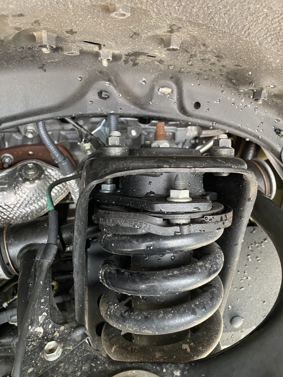

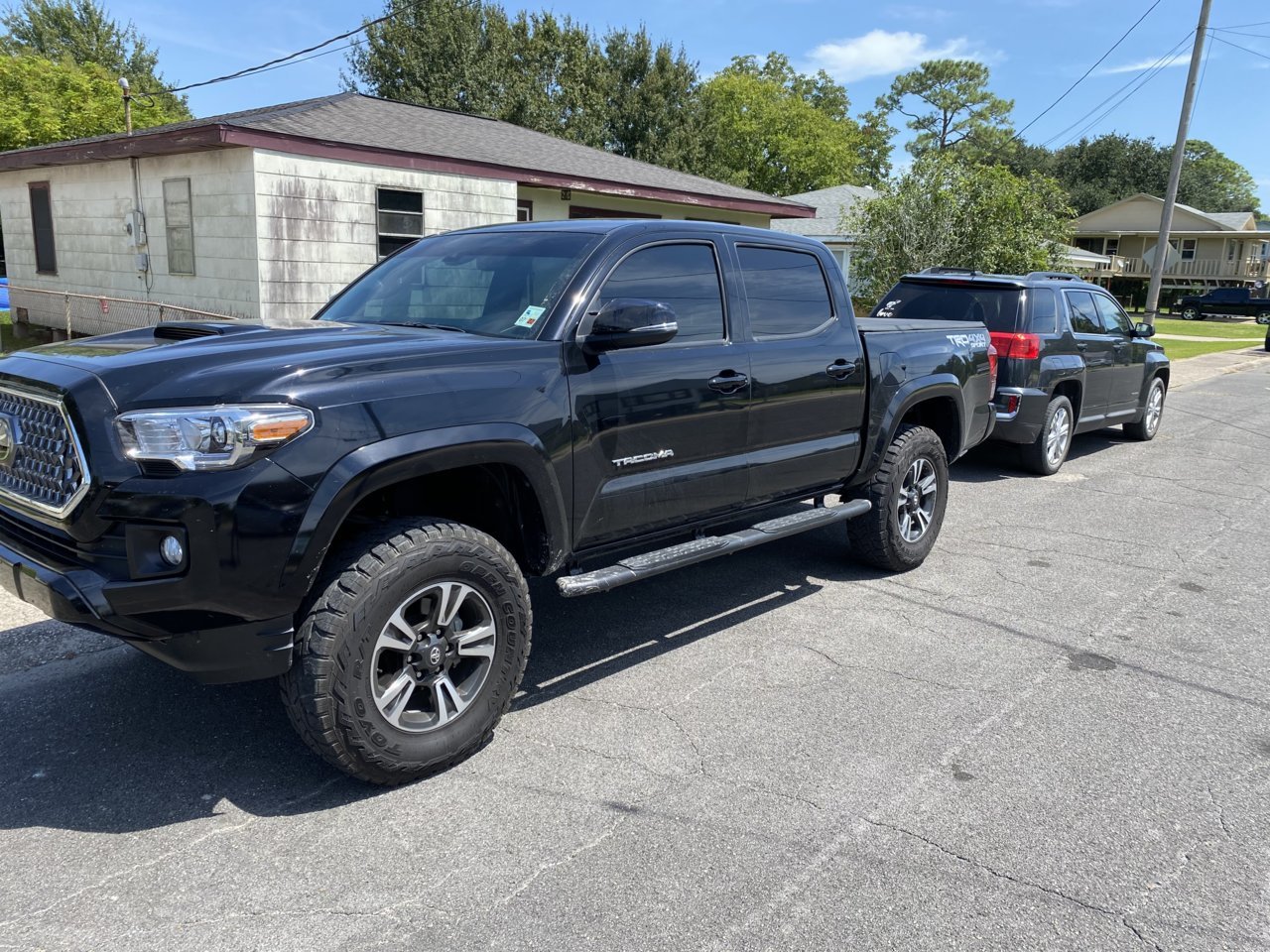

    so my new truck (‘19 Tacoma TRD Sport 4x4) squats slightly lower in the ass than the front.
    so crawling under truck and using the completely scientific method of eyeballing and guessing, looks like it has 2” spacer in front (above springs) and 1” in back (block below leaf springs).
    so how much $ am i looking at to raise the back a little?
    how difficult of a job is it to possibly do myself (i spent 2-1/2 years as a mechanic at a Ford dealer back around turn if the century)?
    and info/help is greatly appreciated.

    Stock Tacomas dont tend to ride low in the rear unloaded. Are the front blocks aftermarket installed by a PO? Guessing you're opposed to removing them?

    pretty sure they’re all aftermarket. don’t know who installed them as they were on the truck already when i bought it.
    looks like they went taller in fron than tear to level it, but probably used too big of a difference so now rear sits slightly lower.

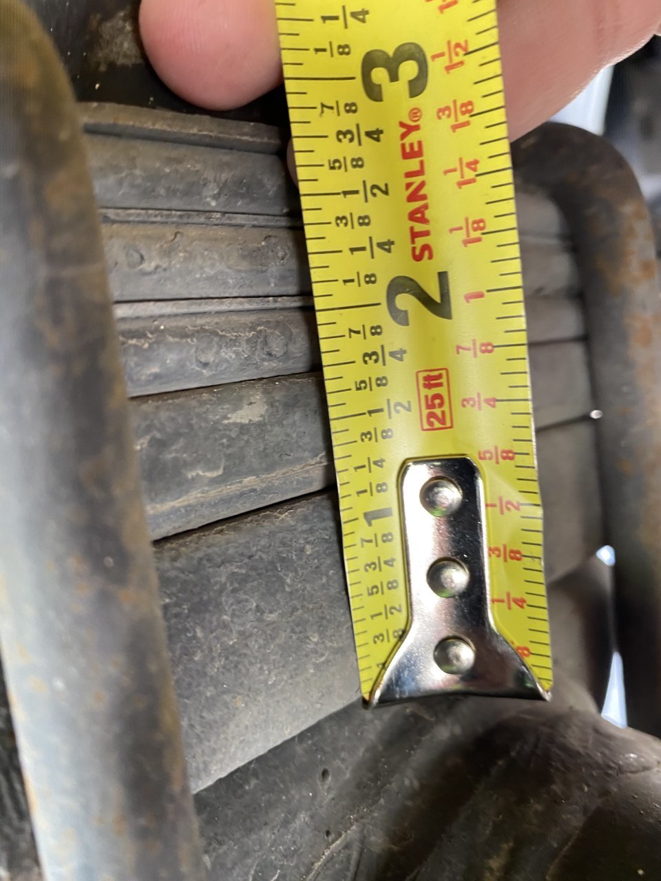

    was able to get under there with a tape today.
    rear blocks are definitely 1”
    fronts are difficult to measure as they are recessed on top
    they are at least 1.5” and maybe 2”
    what do y’all think? get 1.5” for the rear?

    Yes IMO that will look better.

    Need a side shot.
