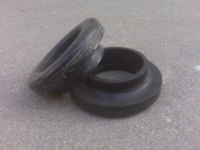

    Don't typical spacers have a certain number of holes, and then a certain number of studs in the spacer?
    -Should just have to remove the strut assembly. Then place the coil spacer on top the entire strut mount/assembly. There should be holes in the spacer to fit over the studs in the strut mount. Then use nuts that were attaching strut to truck and install them now where the same studs stick up through the spacer.
    The spacer should then have studs on it. They should line up with the holes in the body of the truck. You should have been supplied the same number of new nuts as well. Place strut assembly with coil spacer on top back onto the truck.
    -Maybe you have an "in coil spacer" style? I dunno, I'm just assuming on this one. I know this pic has 2 styles of coil spacer lifts, which style are you trying to use?

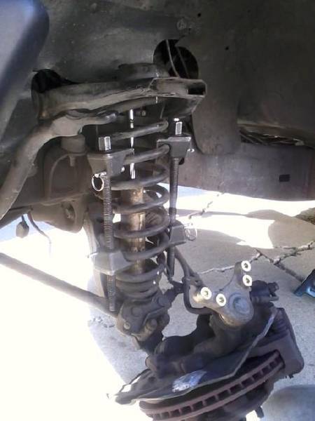

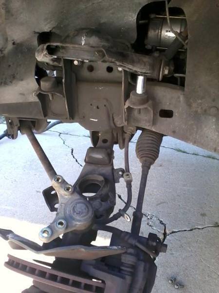

    what type of spring compressor did you use? theres 2 different types. one goes inside the other go outside. ive installed 2 sets of those spacers. both sides in a few hours using nothing but hand tools. make sure this is the spacer you have
    if they look different you have the wrong ones. easiest way is to disconnect the uca from the upper ball joint. pull the caliper hang it from the frame pull the spindle and use the external spring compressor from the local auto parts. disconnect the sway bar and loosen the lca and strut rod bolts. grab the jack and slightly jack up the lower arm get the spring compressors on tighten them snug and jack up a little more repeat till the coil look super short and drop the jack. the whole spring should come out. pop the spacer on the top and throw it back together. heres some pics of one install i did.
    hope this helps you! also you can buy a set of fabtech 3" lift spindles and keep a factory like ride

    If you dont want larger then stock tires then yes the spcer is fine. Best way to do it is to unbolt the upper ball joint, strut rod and push down on the lca. This should have the spring almost fully decomposed which will make it alot easier to remove with a coil compressor. For the rear i would just leave stock. When i sad just the spacer and leaf my rear sat higher then the front.
