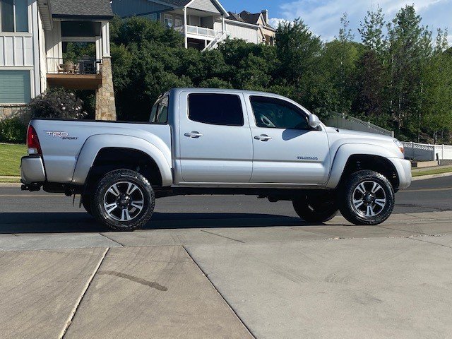

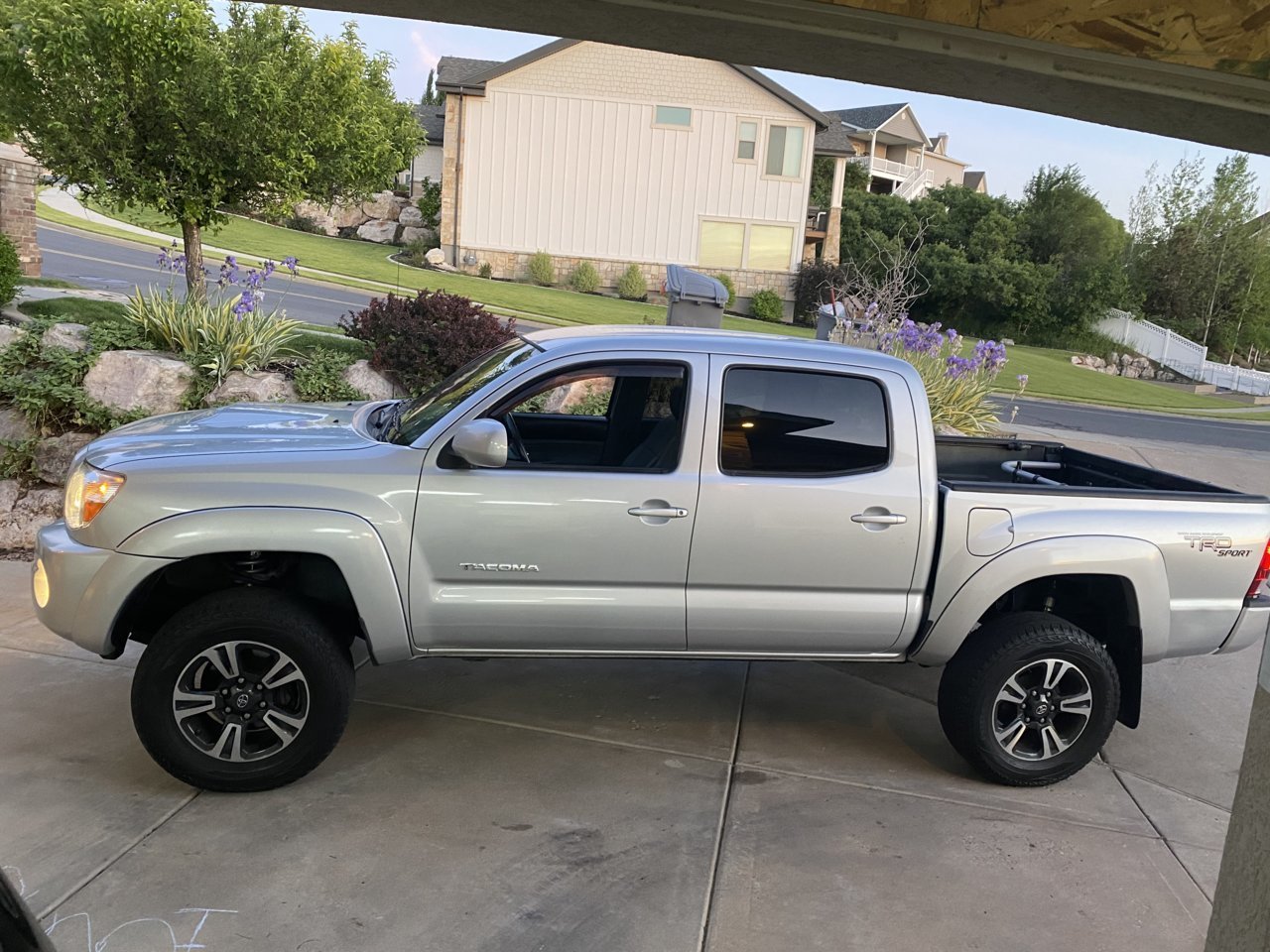

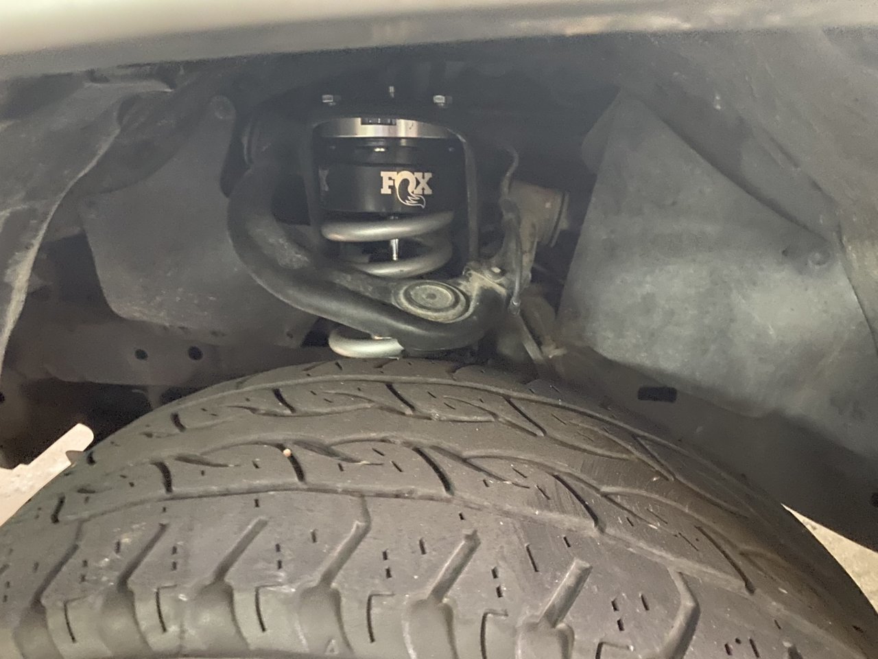

    I recently installed a lift on my 2007 Tacoma which consisted of Fox 2.0's with a 1" spacer in the front with a 1.5" block in the back. I installed it myself and it went smooth and I am very pleased with the ride quality and overall performance. But....
    I hear the slightest change in how it rides, it is a very low pitched rotational noise and hum. It almost sounds as if my truck is in 4 or 3 gear instead of D. This sound is very minimal and mostly can be heard when I am coasting down a hill and my foot is off the gas. Once the gas pedal is engaged the engine sound is louder than this new noise.
    Is this normal? Anyone else had this happen? I haven't go an alignment yet but it doesn't feel like it is out of alignment. I am planning on upgrading to 32 or33's in a few months so I thought I would wait. Should I not worry about it?
