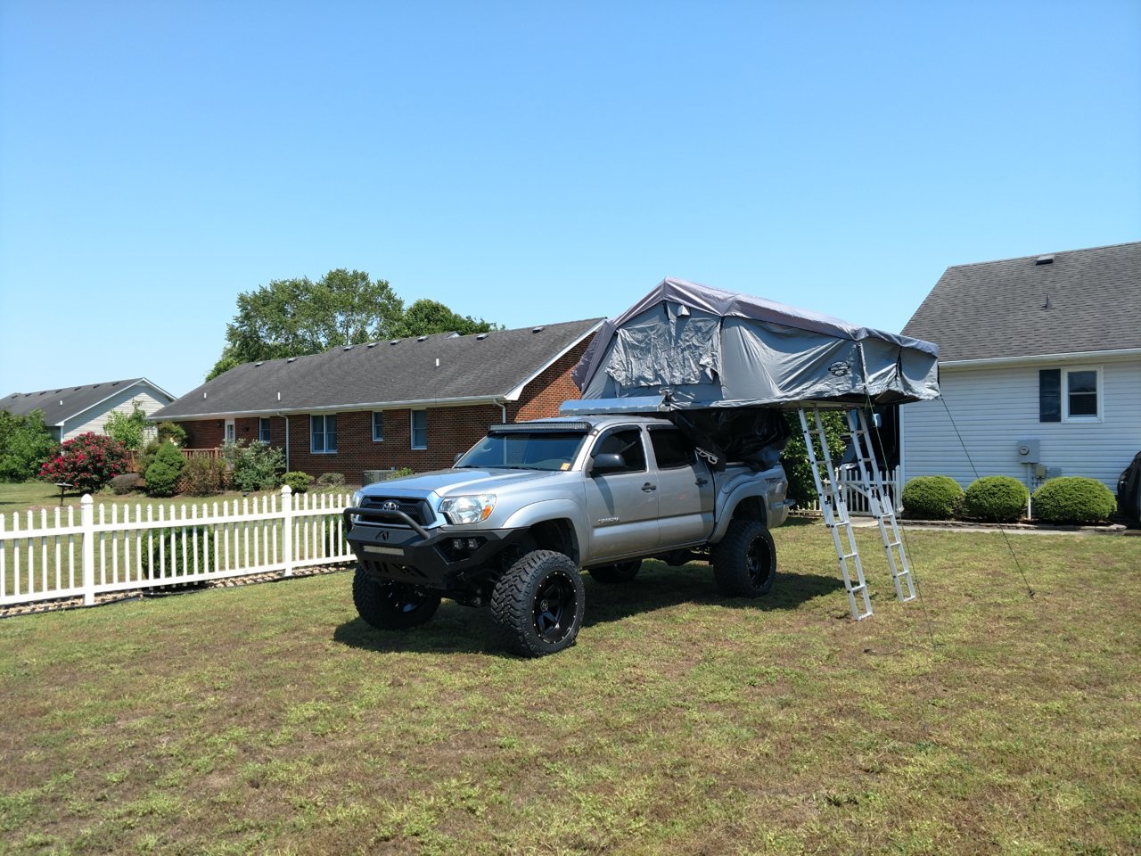

  3. Jul 21, 2018 at 5:30 PM
    #23
    ARDnc
    ARDnc Well-Known Member
    Apr 8, 2017
    #215752
    176
    Charles
    2015 Toyota Tacoma
    Fab Fours Vengeance front bumper
    IMG_20180523_121902651.jpg IMG_20180512_141941479.jpg 6 inch Rough Country.
    lee1092[OP] and TacoDude 72 like this.

    Nice. Ya those 33s look good on it. I was going to do 33 with maybe a 18in rim
