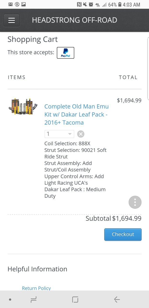

    Would I get close to 3in with this setup?
    Cant decide whether the UCA is truly needed

    Very unlikely that you will get your alignment into spec without new uppers.
    I am running the latest generation SPC arms, very satisfied with them.
    lee1092[OP] likes this.

    You will get between 2.5 and 3 u front and probably 3 and 3.5 in the rear. The plus of getting UCAs is you can get better positive caster on your tires which will help with any rubbing you might get on you cab mount.
    lee1092[QUOTED][OP] likes this.

    I would do the uca's while you have everything apart its the best time and they don't take long to install. I think the 888 coils will get you close to 3", I went with 886 with 1/4" spacers to get my 3".

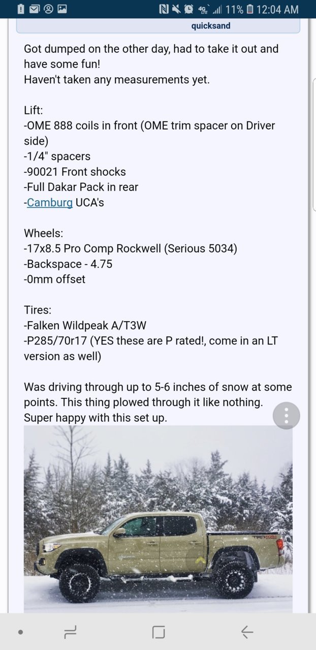

    Ya I was considering doing 1/4in spacers with the additional spacer for the lean. Almost like this setup. Thoughts?

    I did the trim packer also and the front is even side to side.
