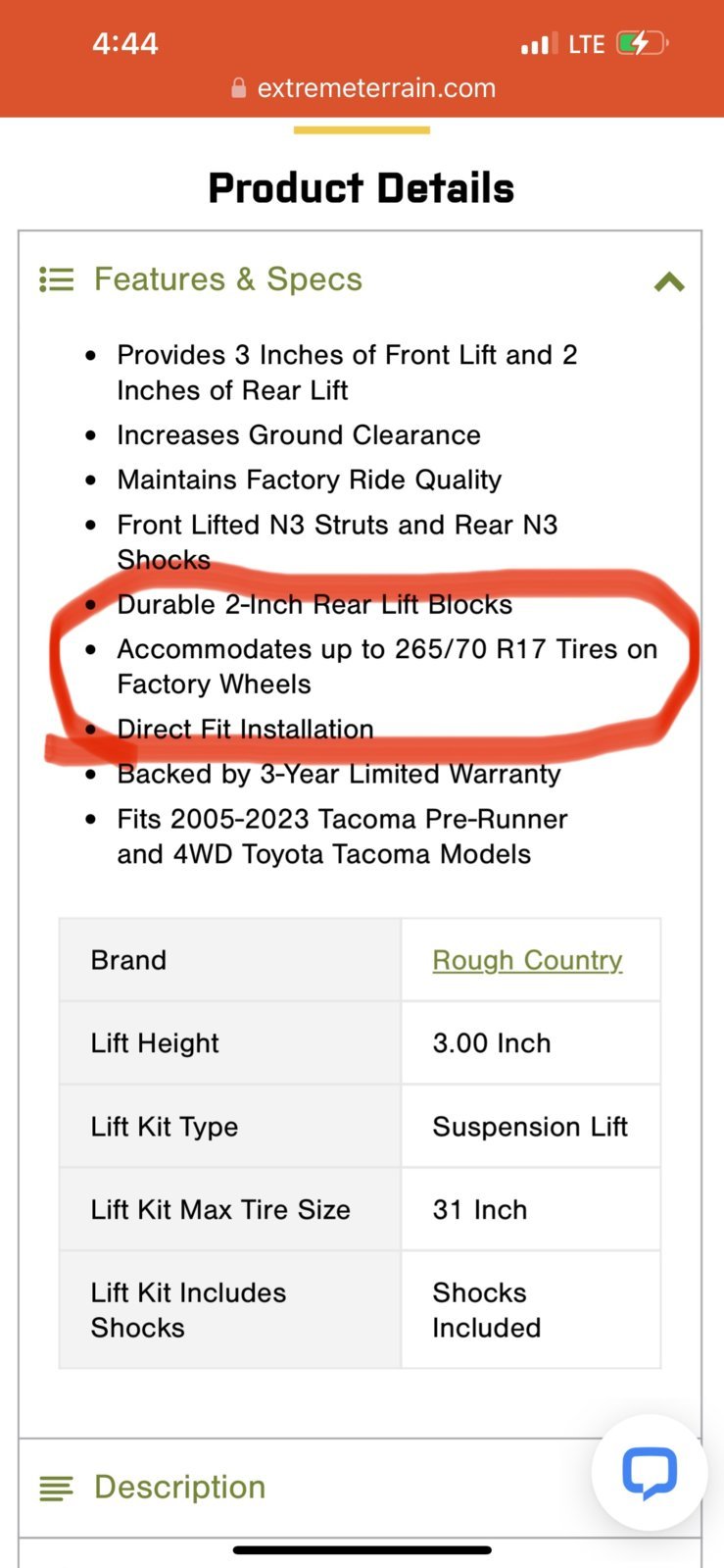

    1st problem is, you bought a street Taco, with street tuned shocks, and small sidewall aluminum rims. 2nd problem is the shop sold you a crappy lift, when you should have gone with Bilstein 5100's for that price. 3rd problem, anyone's old aunt would have told you 285 would rub, and the garage flat-out lied to you when they said, "it might" rub. They already knew it was rubbing.
    1) It should
    2) Sounds like a wheel balance issue. You stock aluminum rims could have also possibly taken a beating with the street tires..
    3) A rim with a +offset willt help, but you may still need the spacers.
  7. Nov 29, 2023 at 2:41 PM

    This thread is a train wreck.
    To whom recommended the “easy fix” of aftermarket UCAs - the OP went with the cheap lift because cheap. Spending as much on UCAs as the entire lift is probably not in the books.
    As for the original poster - sit down and talk with the shop. They PROMISED no rubbing. Have them put the truck back to stock and start over with a 2” lift with Bilstein 5100s and skinny tires aka “pizza cutters” unless you’re convinced that the extra weight and width of the 285 is required.
    Continuing down the path of working with this shop who continues to make money off you by selling you another “fix” (1.5” spacers) will gladly sell you more parts and labor to then fix the next problem (rubbing on the wheel well/cab at the front mudflap location).

    You expect a shop to do this all free of charge? This is not a sarcastic response, I am legitimately curious.
    From the talks I've had with them so far, it sounds like all of the labor, new parts and new tires would be coming from my pocket.
    EDIT:
    I could see them maybe switch out the tires and change the lift as that is part of the rubbing issue, but asking for different a suspension is stretching it..

    I think I'm going to go with the 1.5" hubcentric spacers.
    LINK
    Will report back if things break.

    This thread is going too many directions...Long time lurker here...I think it's funny everyone on this forum recommends expensive, big name parts and fixes for minor problems. Most of you guys sound worse than the shops trying to upsell the OP on new parts for all the issues o_O
    It's pretty common to rub on the UCA with stock offset wheels and large/wide tires. Wheel spacers are probably fine as long as you're not hardcore offroading, racing, and/or jumping your truck. I wouldn't let everyone scare you away from wheel spacers. I've known lots of people who have run high quality wheel spacers for years on many different vehicles and have never had an issue.
    Wheel spacers may create new/different rubbing problems, but hopefully it's just minor plastic trimming. If it were me, I'd start with a set of wheel spacers before ever considering a different lift, wheels, tires, or UCAs... (as long as you're happy with the OEM wheels). If you have the money for those, great, but those aren't "cheap", easy fixes in my opinion.
