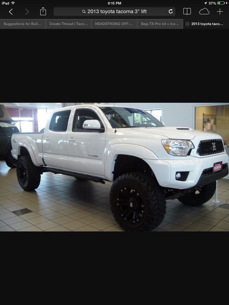

    What's up all? I recently bought my first truck and of course it had to be a Tacoma!!
    I am looking to lift my truck and put big wheels on it. I rarely go off roading but I bought a '13 TRD off road crew cab.
    I am getting mixed reviews of how to achieve the look I am going for. I ultimately want to put 20" fuel rims on (black with chrome inlay) and also have a decent looking mud tire.
    I am looking for the truck to look like the pic below but I don't want to spend a lot of money. Can I achieve this look with the 3" spacer suspension lift or do I have to upgrade,leaf springs, struts and rest of suspension? I was also looking to do the work myself

    Only way you're going to achieve that amount of lift is with a 6" drop bracket lift. Yours is 4x4, correct? If you can't afford the lift, then there are plenty of ways to get 3" on a budget. You could do it yourself for about $400. At that point though 20" wheels might look a bit dumb. I think the tacos with 3" and 17s with some 33s are the best looking ones.

    You could definitely achieve that look but maybe not with that clearance. So let me tell you about my story hahaha. I have a 2007 trd offroad ac and I always wanted to have the wider beefy look of about the same style as the picture you have above. Ive done a 3 inch lift and then later a 6 inch lift on the truck with the help of my father, who is not a mechanic professionally. So both are definitely do-able. And now, my truck sits on 18 inch rims with 35s and a 6 inch lift and I hate it. I didn't want to spend much money either but to do a 6 inch lift right and have your truck running and working like its supposed to at a 6 inch lift is a costly job. My truck runs like a slug because since I'm a student I don't have the money nor time to re-gear, get full coil-overs and ditch the spacers, and what not. So with this said, if I were you I would look into a nice 3 inch lift. I bought my coils/struts disassembled as its a bit cheaper and aal's for the rear. This will help you keep the performance of the ride. I would suggest staying away from spacer lifts as they are going to make the drive a bit stiff. Also, you may be able to fit a 20 inch rim with 33s but I am not sure, especially if they are 12.5 wide . But if you have a 3 inch lift with 18's and 33's(maybe 12 wide) it should almost achieve the same look.

    PS, your goals are conflicting. Especially the 'I don't want to spend a lot of money' part. Do it right, do it once, and you'll be a lot happier, even if you have to wait and save up your sheckles.

    I appreciate the info. I have been doing a lot of research and at this point I am leaning towards a 3-4" lift with 18" rims. I wa looking at either tuffcountry or procomp 3" lift kit and then 18" rims with a 31" tire.
    I have seen spacer lifts that look good as well I am just concerned about the ride.
