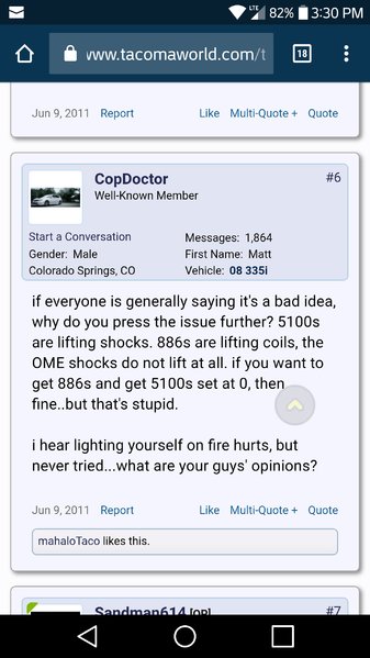

    Just came across this.....

    So confusing!!!!

    Keep 5100s at 0 lift when using aftermarket coils. You should never go more than 3" lift up front. Even at 2.5" ucas are recommended to alleviate driveability issues. Plus the lack of downtravel can make for a harsh ride.

    There is literally zero reason to preload lift coils.
    If you want 881s with preload, get 882s and save yourself from looking like a clueless dude.
    Going to a shop and just saying "I want 3" of lift but I want new shocks" and they'll give you just that, the same shit you have now with new shocks and charge you an arm a leg for it because they know you don't really have a good understanding of something and are just wanting a specific outcome. The destination is what you want, and the road to get there is whatever they sell you. Don't be that guy.
    Also, don't preload lift coils. Buy the right one for your needs, first. If your needs change someday, sell them and buy the proper coil once more.

    5100s can, in themselves, get 2.5" of lift. A lift coil is a lift coil, and negates any preloading lift height a 5100 offers. So if you want a 3" lift, get a 3" lift coil and keep the 5100s at the stock (0) setting.
    You'll save yourself a lot of money (which your budget doesn't allow for) by staying at 3" or below it, in the 2.5-2.75" range.
