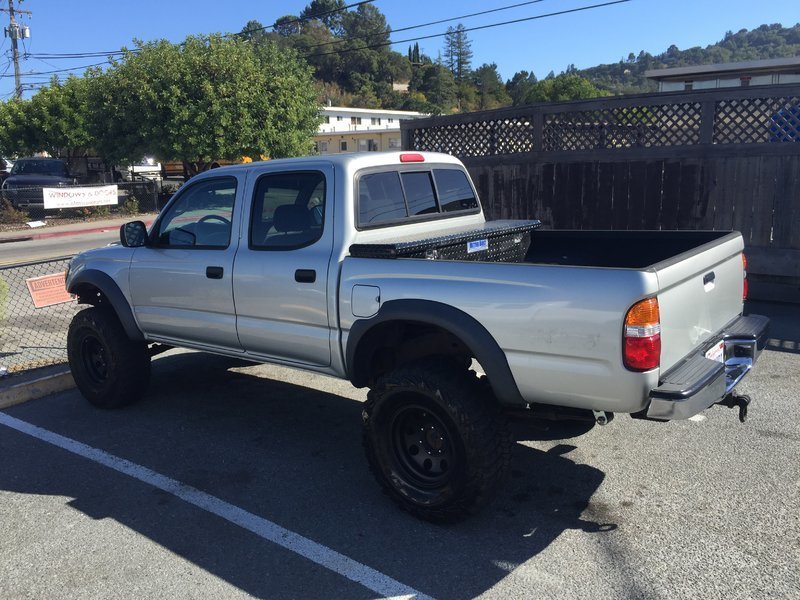

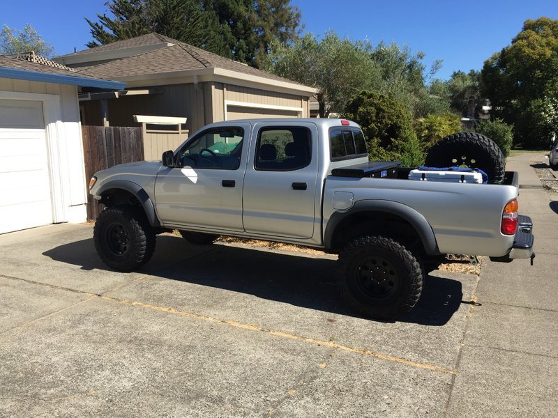

    IMG_6307.jpg IMG_5820.jpgAny idea what lift this truck has and what tire size? Love the stance. I see a shackle in the rear but thats it lol.

    Hes running the 3" toytec kit with 32" mtrs
    https://www.tacomaworld.com/threads/bilstein-5100-eibach-gallery.176037/
    But like already said unless you go with some extra weight its highly not recommended because of how stiff the coils are

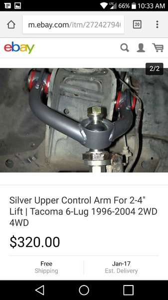

    Screenshot_2017-01-11-10-33-33.jpg wonder if these would be any good? Yes I know they are from ebay. I understand they are noname brand but figured since they are a noname brand thats how they keep the cost down? Says they are heavy duty 4130 chromoly tube. Thoughts???

    standard eibach kit. you have choice of rear lift when ordering (he has shackles by looks of it)
    ebay arms have poor quality components but can be changed out with brand name stuff. but at that point you could just buy some spc arms.

    Ak4T777

    Thx for the info! spc arms???????

    light racing i guess theyre called now.
