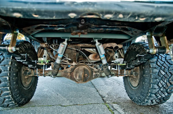

    the 5150's are longer/valved for lifted trucks.
    5100's in the back aren't long enough for rear lifts above 2", but the 5150's are
    Jlee runs 5150's in the back and gets good flex from them

    the longer travel 5100's should do, sorry- I didn't see another reply in here
    They're the ones I WISH i bought in the first place :pout:
    I'll get 5150's soon enough...
