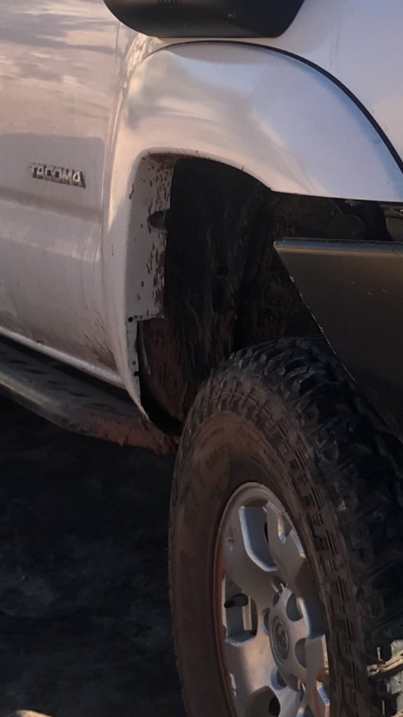

    Pretty good. I did some cutting of the plastic fender flare where I could see rubbing but not much. I also had to adjust the front springs to give it ~2.5” lift and then get it aligned. I took it to Moab without rubbing. No cab mount chop needed. Rear did not require any modifications. Every now and then when sharply turning right into a incline I may hear a little rubbing on the front passenger side, but I think with a heat gun I should be able to fix that. Here’s a picture (don’t mind the misaligned bumper, already fixed) AF6366BA-6904-450E-83D1-991C19CF6E22.jpg

    Thanks @henryp I've been contemplating this tire size for a while. Trying to decide whether I should just go with 265-75-16s or upgrade to 17inch rims which seem to have some more options. I really like the look of those 255-85-16s but I don't want to put too much stress on my dif with stock gear ratio. It's good to know that you didn't have too much rubbing. I am trying to avoid the cab mount chop but also want to gain some clearance with larger tires so these may be a viable option. Thanks again for your input.
