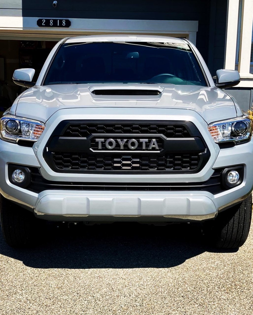

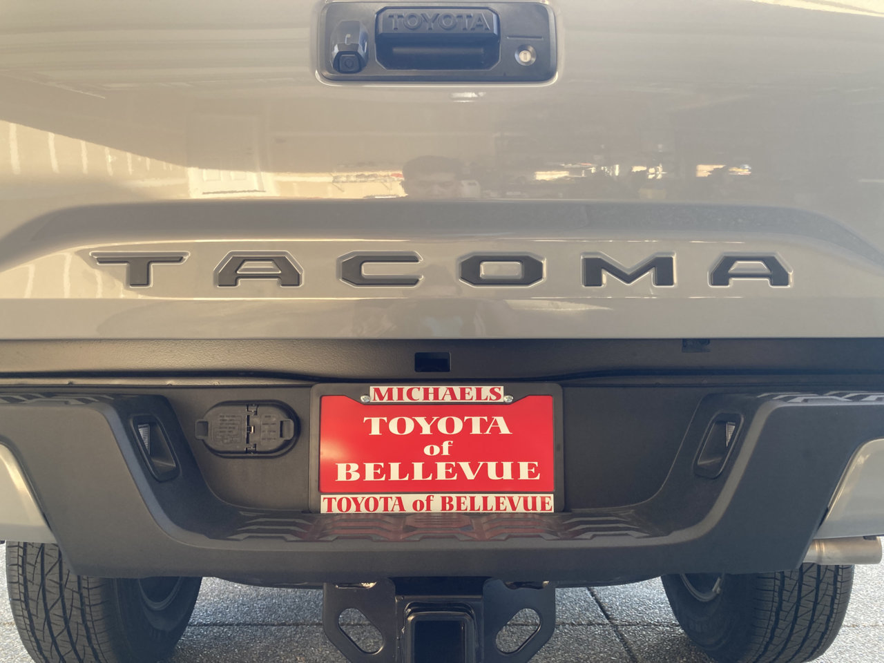

    jcjohn84
    jcjohn84 [OP] Member
    May 1, 2021
    #364460
    6
    John
    2021 Toyota Tacoma TRD sport cement
    Ive done small mods so far on my truck. I blacked out the emblems using plasti dip. I put black letters on the tailgate. I added the oval tube step. I added the Lomax Tonneau bed cover. I replaced the OEM grille to the pro grille. Now im looking into the lift and tires part, then tail lights and headlights after. I know it can be addicting but once i get the set up i want, ill be done. Ive been in other addicting hobbies and ive learned how to control myself.

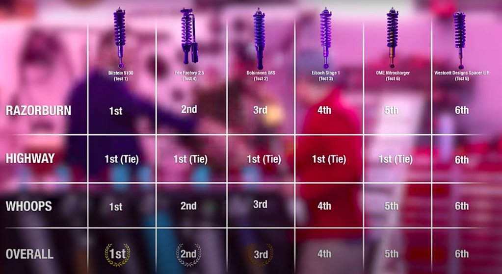

    Tocamo
    Tocamo .
    Jan 16, 2018
    #241451
    5,520
    Ottawa
    Bug-out vehicle
    Welcome John
    I'm like you, where my drive is about 8 kilometres to work, but do enjoy my truck for trail burning (weekend warrior), type of thing. I'll try anything but rock crawling.
    Anywho, most members know that the Bilstein 5100 is the best bang for the buck when it comes to comfort and a nice lift without compromise. You could lift the front 1" and leave the rear stock height. This will give you a nice level stance and you lose the front rake.
    Or you could lift it 2" up front with a 1" block in the rear. This one is the most common, and still takes it easy on your front end parts (CV, ball joints, etc...) Either way, Bilstein recommends you keep the oem coils up front, and that's what I happily did. I love my ride, and especially on the Highway, I dont have that tipsy feel of a huge lift. I've upsized my tires twice now in the 8 years of ownership, and my Taco hasn't had any front end/suspension issues. Either way, you lose that oem Brake dive that used to suck.
    Only thing I haven't done is gone as wide as you want (275), and this is where you may run into rubbing issues, especially if you buy aftermarket rims with different offset. Good luck there...
    Good watch....
