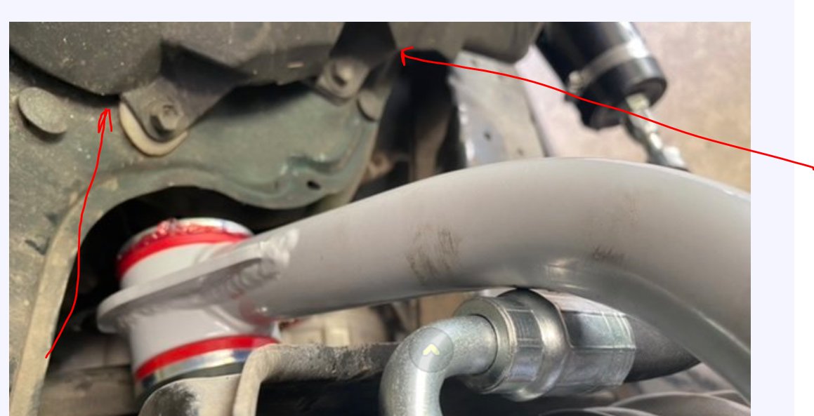

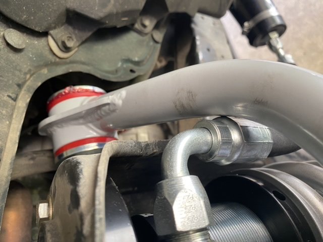

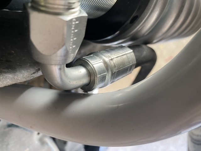

    Good evening all I just lifted my truck and and here are the specs.
    Fox 2.5 w/res
    All pro off road UCA
    All pro off-road expo leafs in rear with fox smooth body shocks. So the problem is when I installed the coil overs and UCA the coil over nipple for the reservoir was hitting my UCA. The coil overs are the extended type that you need the UCA. Which comes set at 3” of lift. Have any of you run into this problem.

    Did you try turning the shock "clocking it "to see if the hose clears in a different position?

    Is the reservoir mounted down on the frame, rear of the wheel?

    hard to really see what is happening here. @newwelder27 how about a couple of pics from a bit further away. Lets see the big picture.

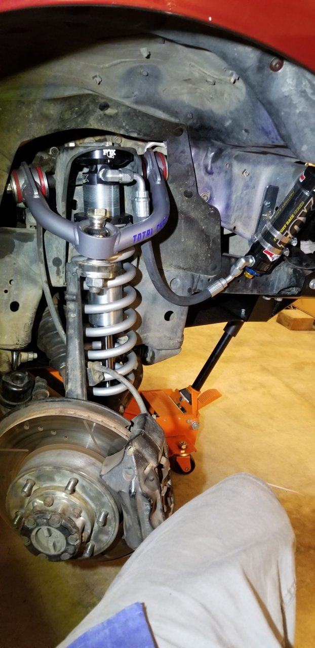

    that's interesting. I have 2.5's with resi's and a TC UCA and it doen't hit.
    Don't know that many people running All pro UCA's these days though. I'd contact trail gear/all pro and see what they have to say.
    Mine:

    maybe I'm not correct, but I'll take a stab. look at the images, @newwelder27 has his output to resi on the back portion of the UCA, where there is less clearance. @betterbuckleup has his output on the front portion where there is more clearance due to how the UCA is designed ??

    yea I agree. hard to tell which direction the 90 deg hose is coming out of the CO in those pictures.
    I would agree with @frizzman, but can't tell if it's coming out of the front or the back of the UCA.

    Its definitely facing the front of the truck side. This cover is on the passenger side covering the washer bottle. Still, be best to have a full view. Another thing I'm thinking, unless I missed it in one of his other posts... I bet he still has the truck on stands and that is @ full droop.
