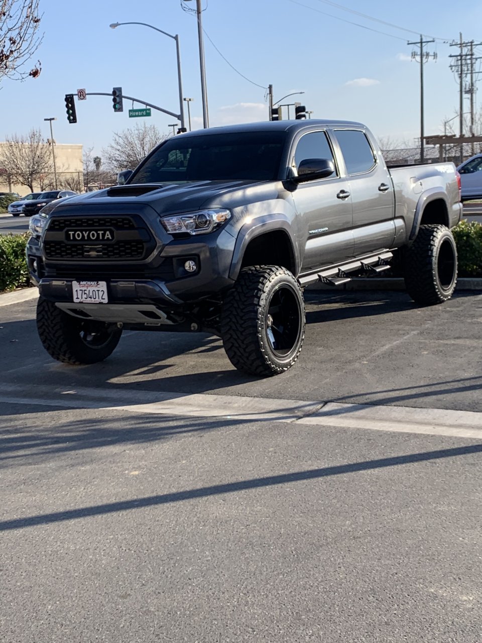

    @gavia if your scared go to church. Lol. Jk. I have a 6” lift and i love it. Just do it, you will be ok. I had a lil issue when I put together the trd pro grill w sensor but I was able to fix the problem. D69681B0-390F-4F33-827D-4468084F5737.jpg

    You shouldn’t have any issue w sensor w that lift, my 6” lift has no issue. I can use cruise control and all that tech stuff, I do have the premium package so I have a that good stuff and runs and works like stock.

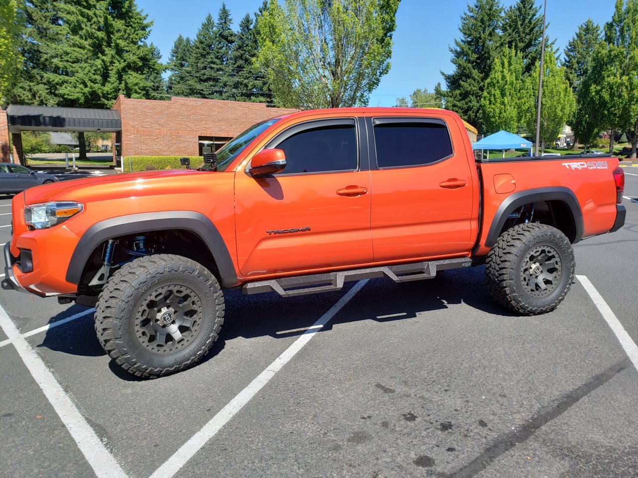

    Have the King 2.5 bypass suspension lift with Total Chaos UCA's and I'm at just over 2-1/2" front and rear. No shims, no bushings, no carrier bearing drop and no vibrations. Guess I got lucky :)

    Beautiful truck and love the color! Too bad Toyota stop making inferno red(orange) for 2109 Tacoma’s. I wanted one so bad and to find out it wasn’t available anymore.

    Thanks for the compliment. I was in love with this color when I saw first saw it on the 2015 TRD Pro. Found out they were discontinuing it after 2018 so I figured I better pull the trigger.
