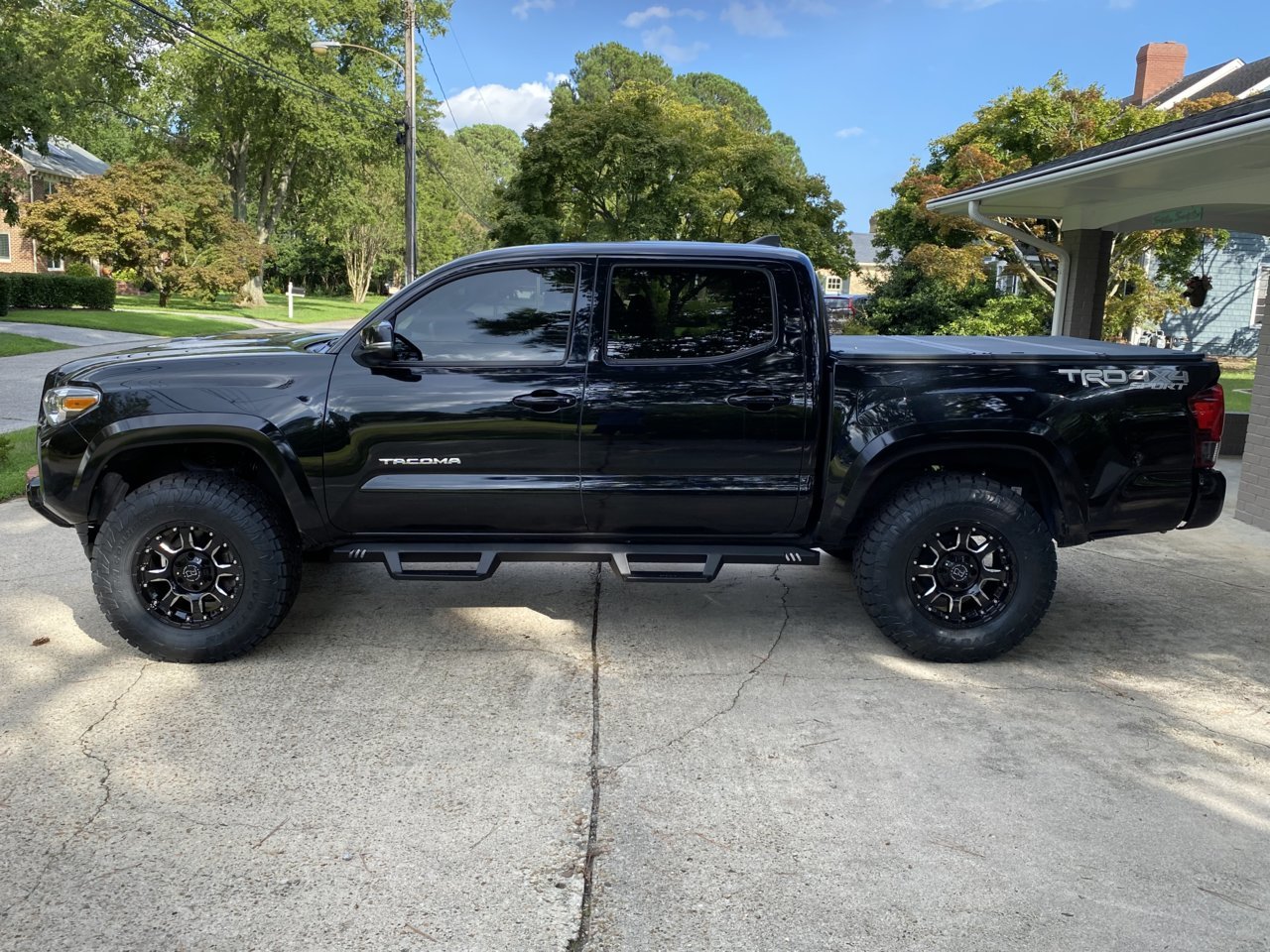

    214DD164-DEC1-4A84-8261-7F809435F092.jpg I just got the Bilstein 5100s on front and back, it lifted and leveled the truck by about 2 1/2 inches and I think it looks great and rides really well too

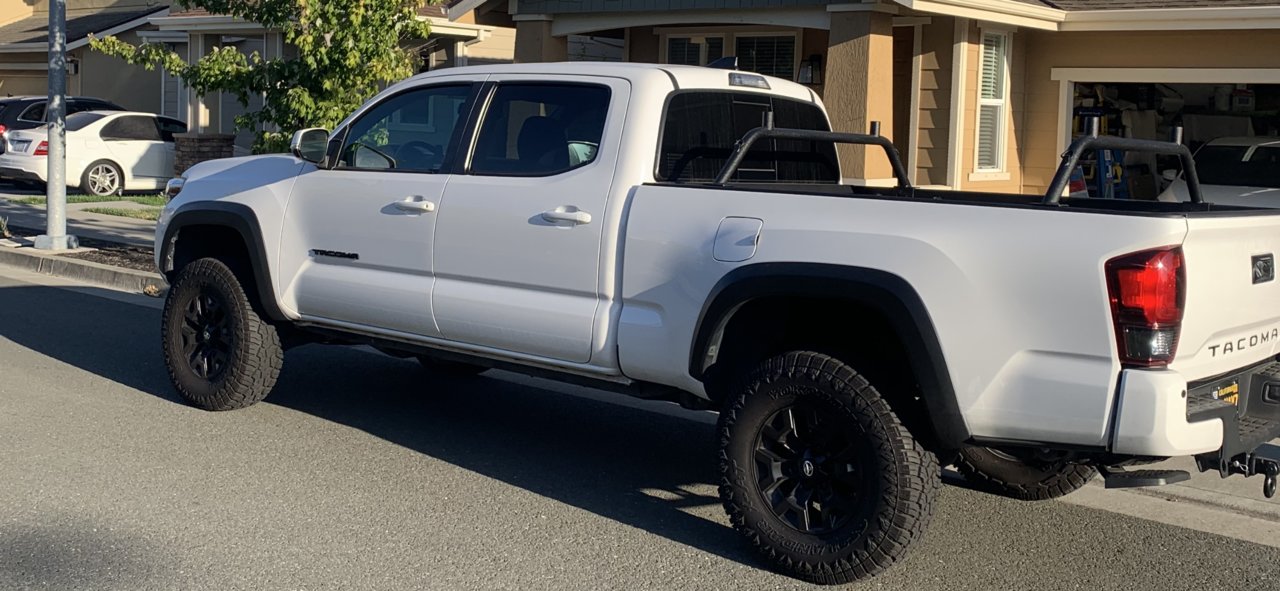

    5100’s all around 2”
    Front lift rear 1.5” aal. No complaints here. IMO great budget lift light off-roading and camping etc. Ride is stiffer but in a good way. I would recommend going to a Off-road shop for install.

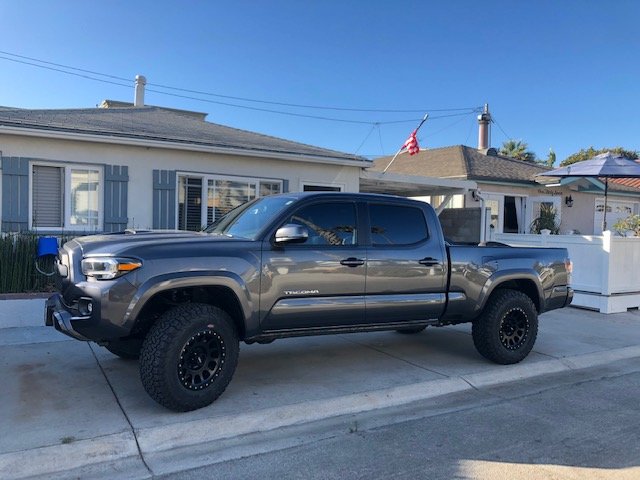

    Just installed 5100's all around. Front is on the 4th notch with stock Sport coils. Running 285/70/17 tires. Needs a 1" block in the rear to level it out. Super comfortable though

    Oh wow, you have 285 on your tacoma? Any rubbing?? If I want 285, do i need to regear or anything? I have 5100/887. 2.25" lift in the front and 1.5" in the rear. It's very level.

    Zero rubbing... that considered I did have a CMC done and I trimmed a lot of plastic on the front and rear of the wheel well!
