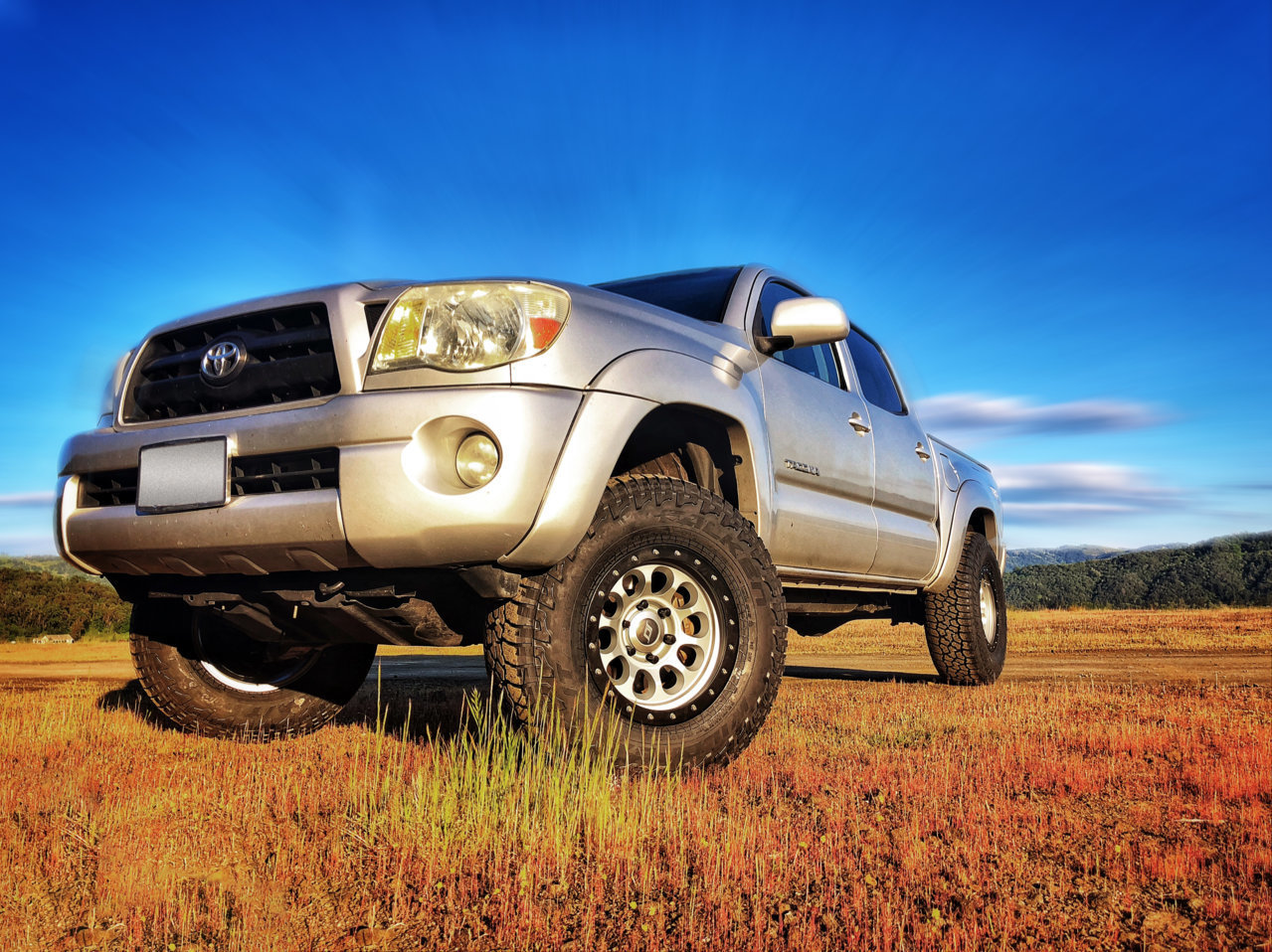

    I went with 265/75r16 set at 1.75. It seemed to be a good compromise of a taller than stock tire and decent ride and on a budget. 4E323BD4-B9ED-4A7F-88B4-ED13754369E4.jpg

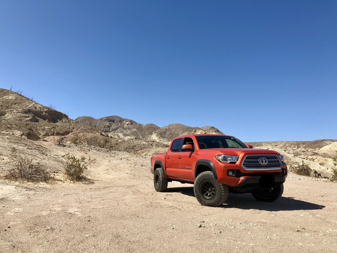

    Front: 5100's @ 0.85 Rear: 1/2" spacers 265/75r16 on RAY10
    I have the older Bilsteins at the first notch which gave about 0.85” lift, and a 1/2” spacer in the rear, 265/75r16, and it rides great. My understanding is the next notch would be okay ride wise, but going higher you start to notice it over bumps. Where I have it now there isn’t much if any difference from stock. The tires made a bigger difference in how the ride feels (better, more stable over bumps, stock tires were soft and floaty).
    You are definetly not going to run the Bilsteins at 2.5” without having problems constantly bottoming the strut out and potentially damaging something. I am pretty sure Bilsteins explicitly says this with the older version and the newer version specific to the 16+ won’t even allow that much adjustment.
    This doesn’t even get into the issue where the max lift the Toyota front suspension can realistically handle without compromises in geometry occurring is really about 2” from stock on the 16+. Not to mention drivetrain angles.
    And coz we’re having a Ray10 picture whore contest:
    Canadian Caber, Alden and TBV like this.
