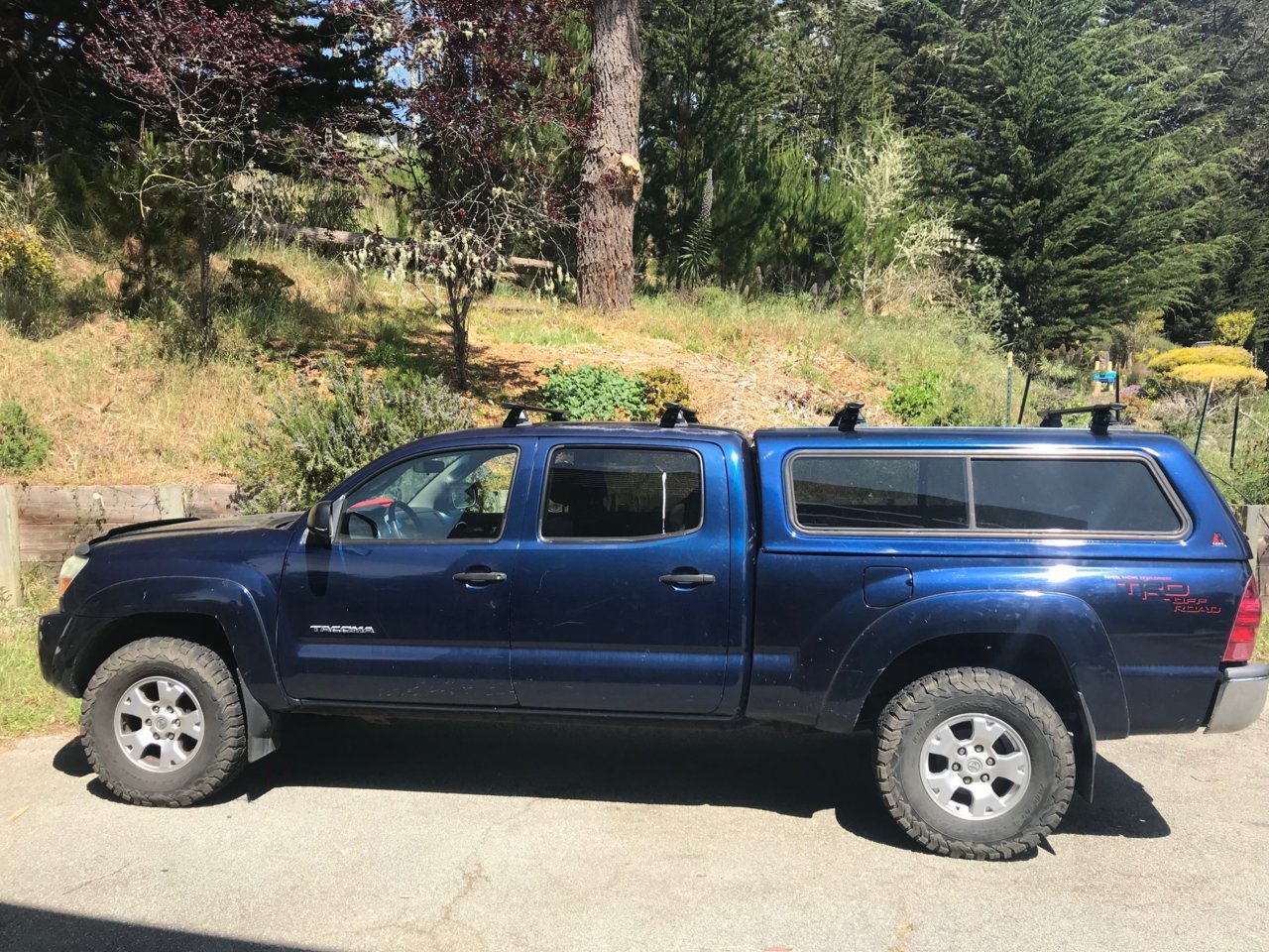

    I have read through the various threads on the best lift for a 2nd gen Tacoma but I have a unique question that I am hoping the community can help me with. I have 2005 Double Cab long bed with 225,000 miles. Last year I added bilstein 5100's all around, replaced my stock front springs with OME springs, and then had the rear leaf springs replaced by the dealer (recall). I put 1/2" level in the rear to make the truck level. However I have been doing some more off-roading in the last year, and have bumped the bottom a few times, broke my trailer switch, and have realized that my truck is a little to low and unmodified to make these trails. I have 16" rims with ko2 on them. I would like to lift my truck a bit to make it more trail ready. Since I have already invested in new shocks and springs I am wondering if there is a way to use what I have and get a 3-4" lift? Most of the what I have seen on the internet has been sold as a kit (includes springs, shocks...). I don't mind spending some money to do it correctly. I also going to add a front receiver for a winch and perhaps some rock sliders as I dented my truck along that area a few times last year. Any help would appreciated.
