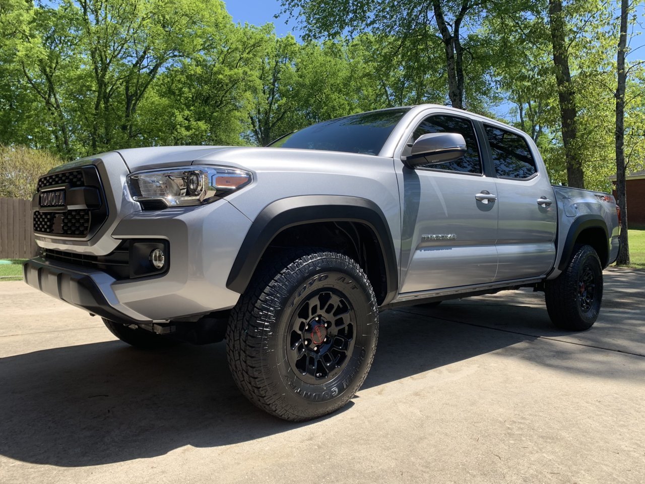

    im wanting to lift my truck around a inch and half in the front and do 1 inch in the rear. I don’t off-road my truck I bought Incase I ever need to use 4wd. But I hear all these things about the needle bearing but then you watch the forums and you see all the trucks with lift and none of them talk about it. But just wonder what my best option will be because I’m wanting to run cooper st maxx because they are a true 32 in size. Thanks here is a picture of my truck as of now
