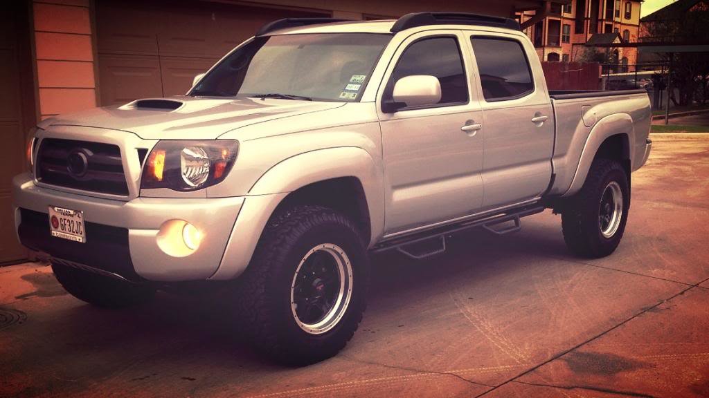

    Well thank you guys for all the advice. Ntilehman thanks for the coil over adjusting help. This is how the truck came out.

    I think i may have a little case of the taco lean, but can't be too sure until i get it to leveled ground.

    I think you are looking good where it's at man. Like the wheels on that rig too.
