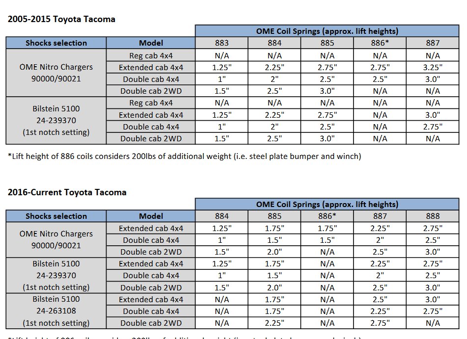

    It's hard to tell from his avatar, but it looks like he has a DCSB Trd Sport. Here's a chart from @HeadStrong Off-Road showing how much different coils give.

    OP is looking at a 3 in spacer lift and the closest he'll get to that with OME coils is the 888s.
