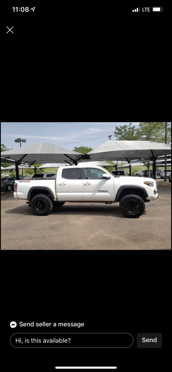

    Got a 2020 Tacoma TRD OR that already had a lift kit on it - has Eibach pro lift kit with Dirt King UCAs. My question is, the back sits slightly lower than the front (1/2 inch to an inch max) and instead of the provided Eibach rear blocks he put different what looks to be slightly bigger blocks. Is this okay and can I adjust the front snap rings to lower/level the front without anything being affected?

    May just want to lower the front end a bit

    Okay that’s what I was thinking, should be good even with the other blocks that’s been put in?

    Well i hear that blocks can increase axle wrap so the big blocks can wear ur leaf springs faster than normal.
    blocks are a shortcut but theyre not terrible. U could leave them and save up for a new leaf pack like dakar or deaver

    Measure the block he used and go bigger. If he used a 1 inch block try a 2 inch block. Its easier than lowering the front and then another alignment. Nothing wrong with a 2 inch block but that is the largest I would use.

    So I took it to a 4x4 shop today to get an in person opinion, he said it looks pretty much level to him maybe a half inch difference and if I notch down the front a half inch it may interfere with the tires rubbing, and that it was perfectly fine with the blocks on there. And if I start putting weight in the back that they can add airbags in the back so it won’t sag or aal

    Looks slightly nose high in the pic to me. Even more so when you put it in gear and drive down the road.
    Front could be lowered but would have to diassemble the front suspension or u could switch to a taller rear lift block or add an AAL to raise the rear.

    Does it look bad to you? It’s like a half inch difference once I start putting weight in the back I’ll prob do AAL

    Not good or bad. It comes down to ur own personal look preference. If u haul loads frequently or tow it might be worth adding an AAL
