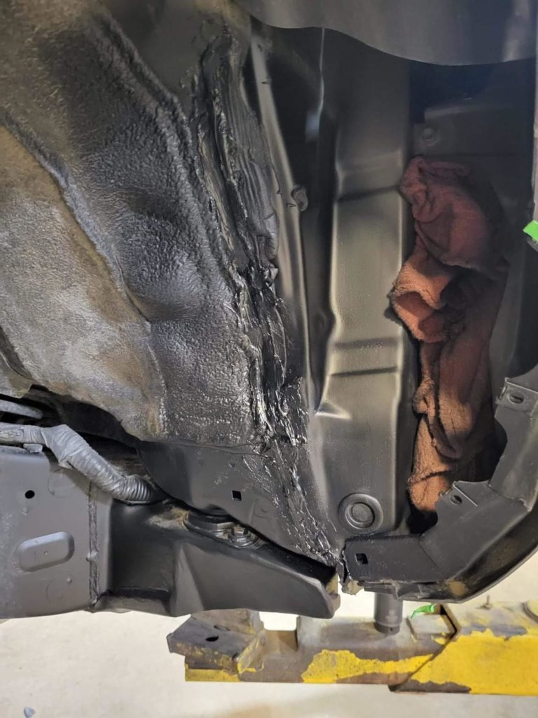

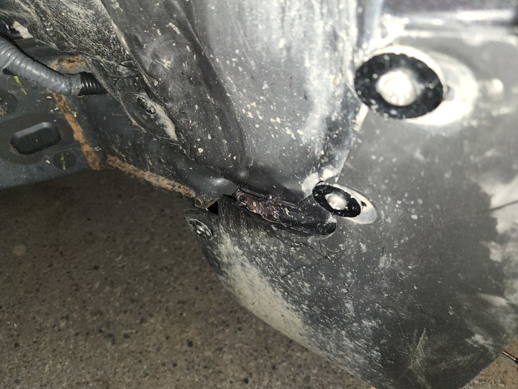

    3" is to high on these trucks in my experience. I had my front at 3" for a few months as I set it there anticipating some spring sag and the additional weight of my bumper/winch that I was waiting for. The problem with a lift that high is you have very little down travel so the shocks can easily top out which doesn't sound or feel good at all.
    I only recommend the bilstein combos as they are the most tried and true suspension upgrade on here and the 5100's do not break the bank at all. The 5100 or 6112 have the same adjustability with the pre load collar either or will easily give you 2" of lift up front.
    The dobinsons leaf pack I'm recommending over my experience with ome leaf packs. You can get different load ratings to hit a lift height based on how heavy your set up is.
    Try to aim to match lift to retain some rake from the back to the front. So if you lift the front 2" lift the rear 2" to retain the factory rake. The trucks simply drives better especially if you ever intend on having any weight in the box.
    Just remember lift does not clear tires on these trucks anywhere besides ride height as the second the suspension cycles the tires end up where all the obstructions would of originally been.
    On a 17x9 -12 your best odds of clearing involve an accutune uca custom alignment and a 285/70r17. I hardly fit mine on a +1 but all trucks are a little different so you might get lucky and not need a cmc. But if you have to do a cmc for a 285 might aswell goto the 295 as it will fit at that point.
    Definitely don't overlook the clamshell bushing, carrier bearing drop and or angled axle shims while planning this out. It will clean up all the odd vibes that can come with lifting these trucks.
    Ypu can see some of the plastic moulding that was done to help clear my 285's but you can see there's no rubbing on the cab mount. That's at 2" lift 17x9 +1 and dirt king uca's custom alignment.
    This is the clearencing that has been done to clear my 295's on 17x9 -25 and 17x9 -38. Cab mount chop, pinchweld fold and flare trim.
    I dreaded the idea of a cmc for a long time and didn't want to do it. But knowing what I know now just do the chop early and don't fight with it especially if you intend of wheeling the truck at all.
    To touch on re gearing I am not re geared on 295's and I'm a bit of a heavy build and tow. I can still get reasonable mileage and unless I intend on spending more time on tougher trails I don't forsee myself regearing for a bit.
    If I can manage that on stock gears it's not 100% necessary
