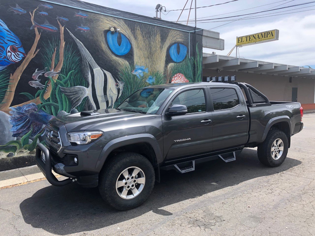

    Kings 2.5” front and rears from Accutune / ICON RXT LEAF PACK black badges doors and tailgate / method 315 / 255/85/16 Yokohama G003 / magnaflow exhaust , axle dump / meso int delete kit / meso led map lights / dome lights / wheelers front super bumps / accutune Flip kit with spacer and new bumps / Cali raised fog light pods / Cali raised ditch lights / RCI FULL SKIDS / SLIDERS / RCI rear bumper / rigid backup lights / tuned on 4.88’s
    Yes. IMO 2” will look good with 265’. Now if you want to fill in gap like member stated above. Cmc etc. You could do 2” and some 255 tall skinnies? Pic for reference with 265/75/16

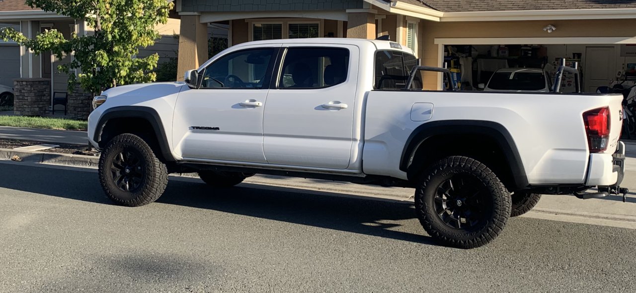

    285's, 2" lift, full turn angle w/o rubbing, still have my air dam, No Cab Mount Chop required.
