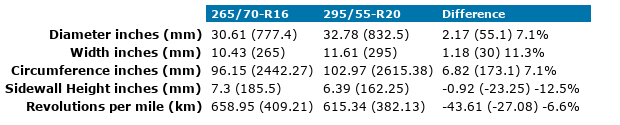

    How much lift is required to fit 295/55R20 size tires on my 03 Tacoma. I already have a 2" Front Leveling Kit. Thanks

    You'll be fine with the current leveling kit. You may have some rubbing issues with a tire that wide.

    from the online tire size calculator
    u should be ok but as said above youll simply need a bit of trimming of some plastic. whats the backspacing of the rims?
