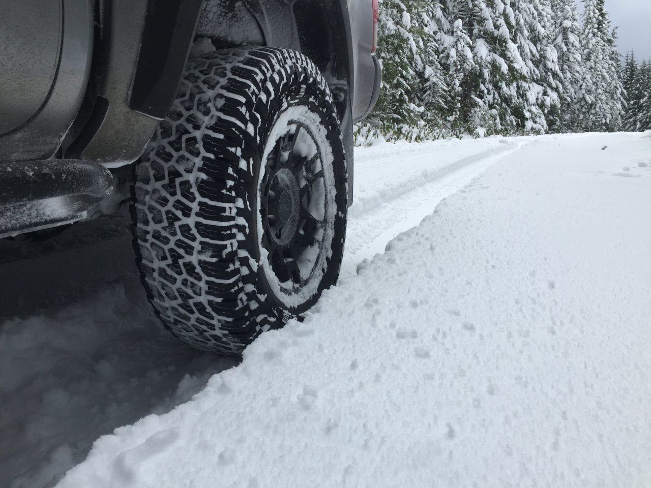

    I'm new here and new with trucks altogether, and recently got a 2019 TRD Off Road with TRD Pro Rims and Pro Comp Xtreme MT2 265/70/17.
    From an aesthetic standpoint I would like the truck to sit a little bit higher and wouldn't be opposed to increasing my tire size down the road, but would really like something that wouldn't have my current tire/wheel setup look too small or strange.
    From a performance standpoint I would like the additional clearance and wouldn't want to do anything that would jeopardize performance or potentially safety. I see myself doing fire service roads and other mild to moderate 4x4 driving. I do like to backpack a couple times a year in southern Utah so I definitely see using the Tacoma out there on future trips.
    Budget - I would like to be under 1k for parts if at all possible, but not sure if it is.
    Thanks for the input.
