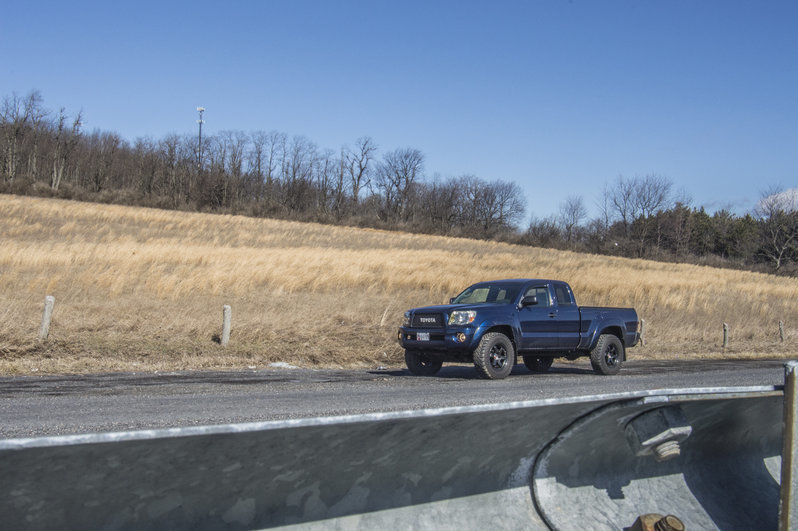

    Take a look at @AR15xAR10's setup. You guys sound like twins.
    Mason. Pics.

  8. Mar 13, 2017 at 9:57 PM
    AR15xAR10
    Apr 13, 2013
    #102024
    57,032
    2013 TRD Sport 4x4 V6 ACLBFTMFW
    I would highly recommend my setup to you.
    5100s set on 0" on 883s netted me 1.5" and no UCA was needed.
    TSB leafs, +1" 5100s and 1k sumosprings for bumpstops netted 0.5" in the rear.
    Truck sits level. 32s fit perfect.
    I personally feel the more lift you have, the more tire you need to make it look right. So this would level your truck and make it not look weird with stock sized tires, or you could go to a 265/75/16 and a wider more agressive wheel like i did (though mine are 17s so 265/70/17)
    Plus i have 74lbs worth of skid plates up front...
    T4RFTMFW[QUOTED] likes this.
