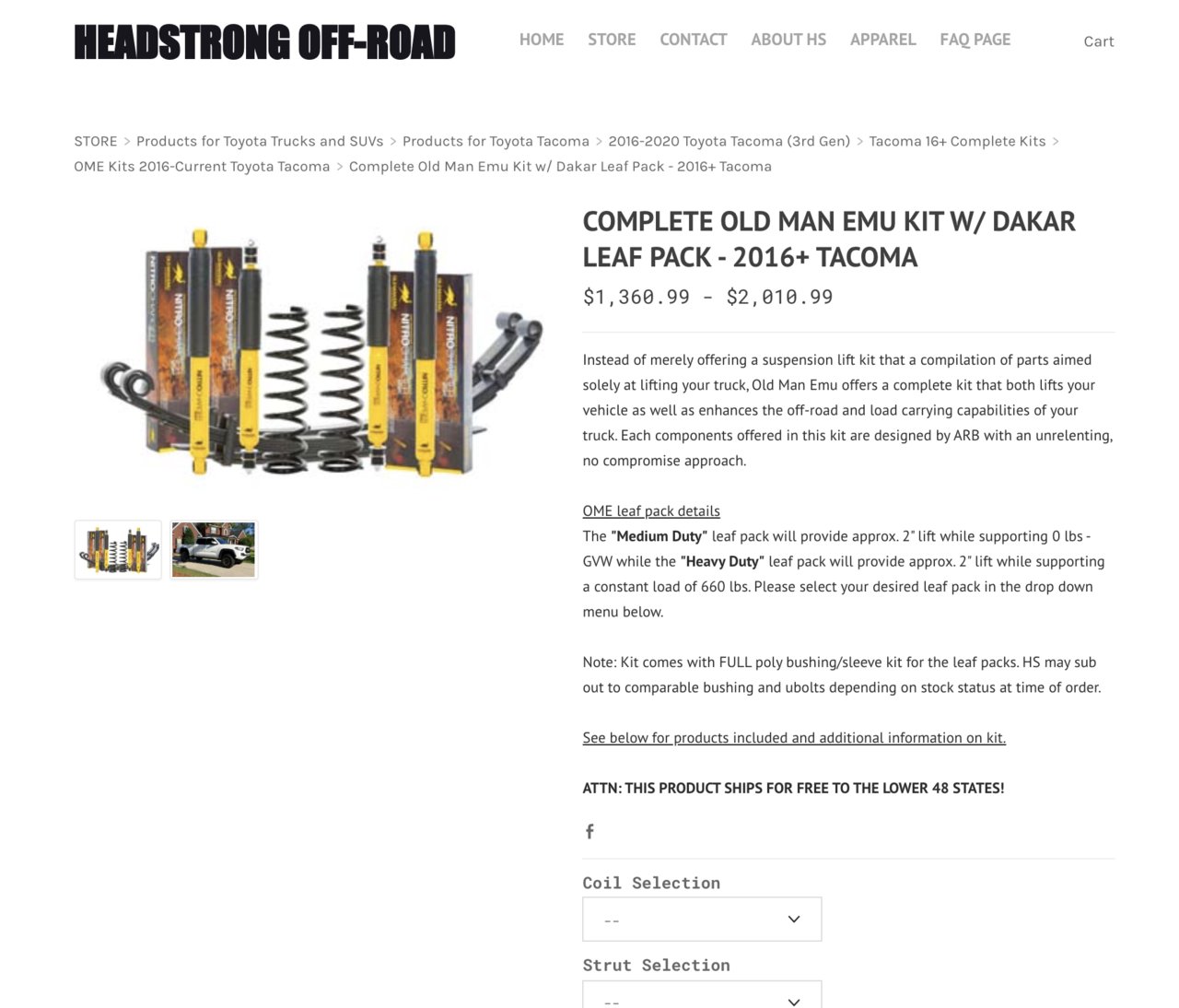

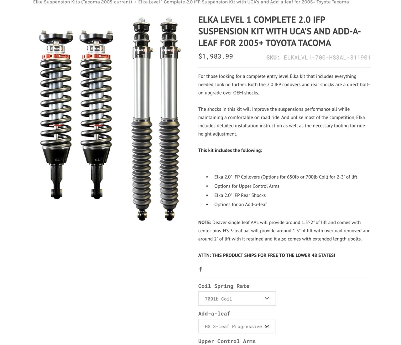

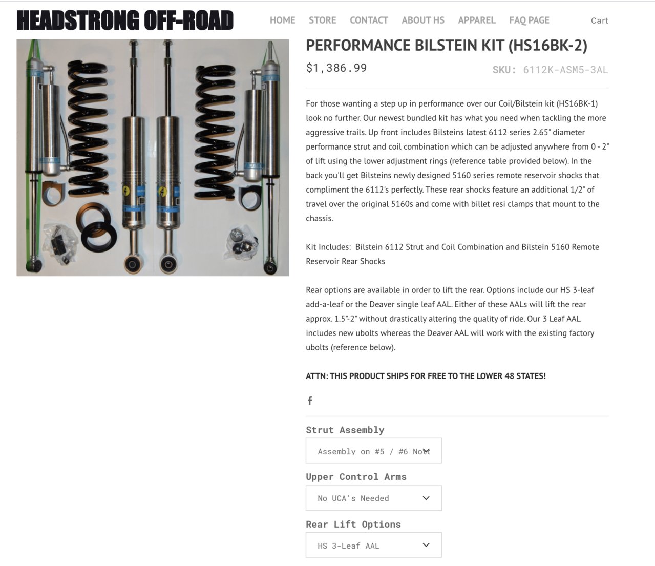

    So here's the two Im going back and forth on below from headstrong. Very undecided at this point lol. I'd be down to consider hiring it out or hiring a helping hand though... Done a fair amount of suspension work in the past but I'm for sure rusty and dont have the tools anymore.

    Def more confused than ever lol. This group originally had me sold on the bilstein 6112 / 5160 kit, Sierra Expeditions then swayed me on the OME, but now after chewing it up with the headstrong rep forever they had some very compelling reasons for going with Elka.... I know they have a pretty solid name in the atv world and wondering how that translates to passenger vehicles. Blew a tire off-road last weekend so need to pull the trigger asap so I can grab me a new set of new tires.
    Sidenote: Excuse my ignorance. I've opted for the HS 3 leaf AAL. This seems to be the best option with this kit... Not sure if this is the right move or if I even have a choice.
    Thoughts?
