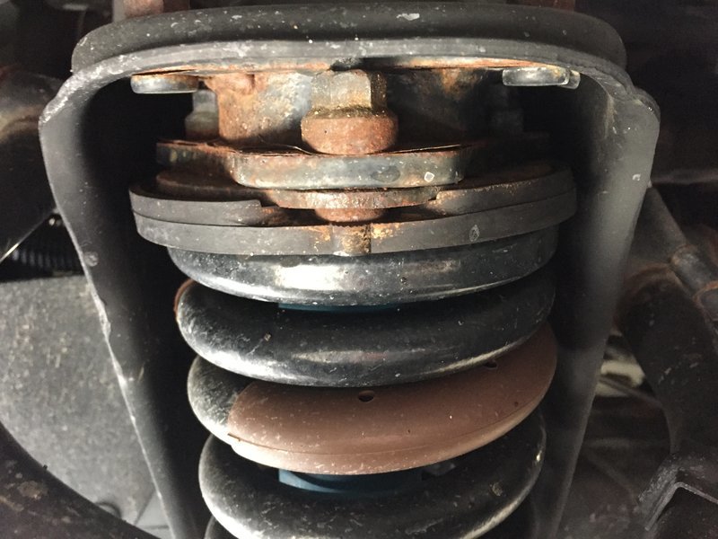

    image.jpg Thanks for the replies. I will go ahead and remove them.

    Those look similar to mine so you have about 2.5" lift up front. So you could go with a smaller spacer, ditch it all together or a lift block in the rear could bring arse up pretty easily too if you want to keep the height. It just maybe that the truck was not aligned after the lift because you should be able to bring the camber back into spec. at least with mine I was able too.

    So when you installed your spacers, did you have to get rid of any original parts from the strut spring assembly? Or the spacers just sit on top of the assembly?

    The spacer is installed right on top of the strut nothing is removed and its easy to go back to stock. (it will need an alignment again)

    Like you said the spacer just sits on top, actually bolted on top of the shock/spring assembly-using factory hardware. Then the spacer comes with a couple more bolts to mount to the truck. 100% reversible. If you pull it there is no need to find bolts to replace what was done.

    also the strut will be turned 180° to line the bottom hole and top plate bolts of the strut up after you take the spacer off
