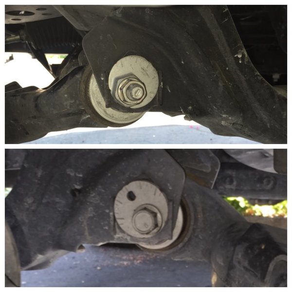

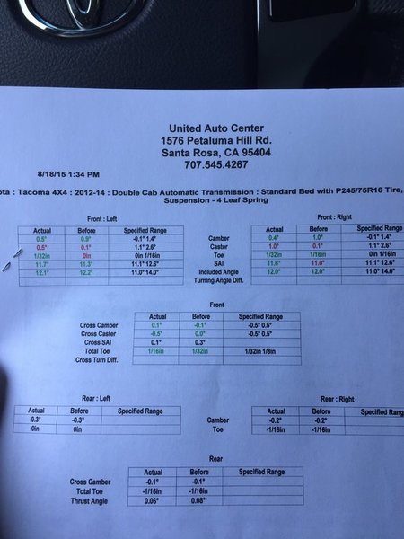

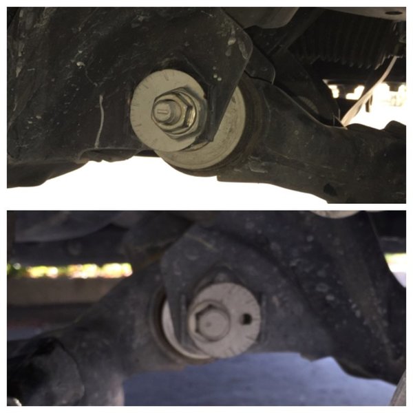

    Well. The shop seems to have known what they were doing. My alignment cams are maxed out and as good as they can be. UCAs are needed.
