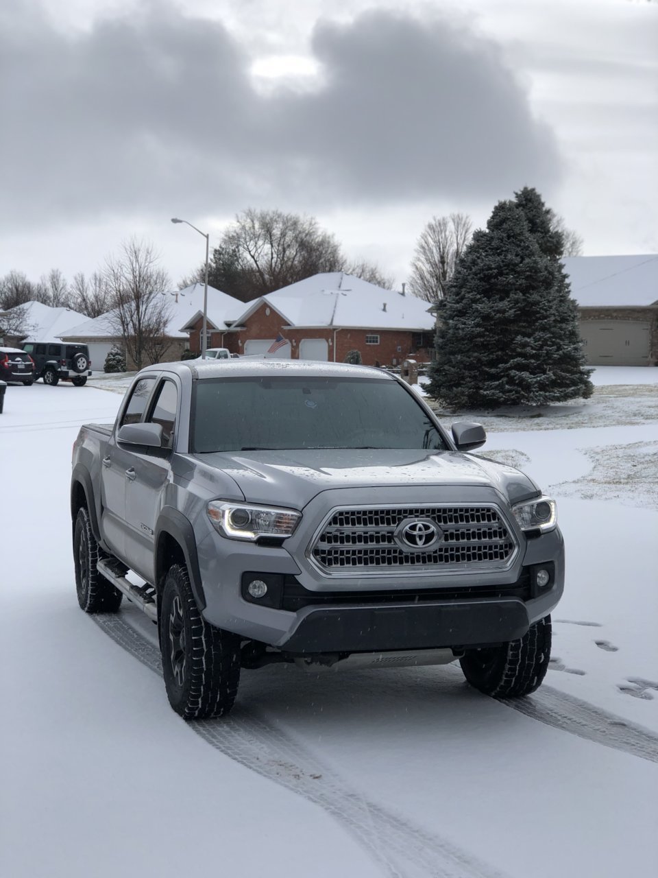

    5EB384A1-E70B-463D-B371-7F576DD1BCA5.jpg How y’all doing, been lurking for a while and finally got around to actually making an account. Wanted to get suggestions and personal reviews for affordable lift kits(non spacer). As well as daily driving with lift/bigger tires.
    And if re-gearing to the 5.29 is necessary.
