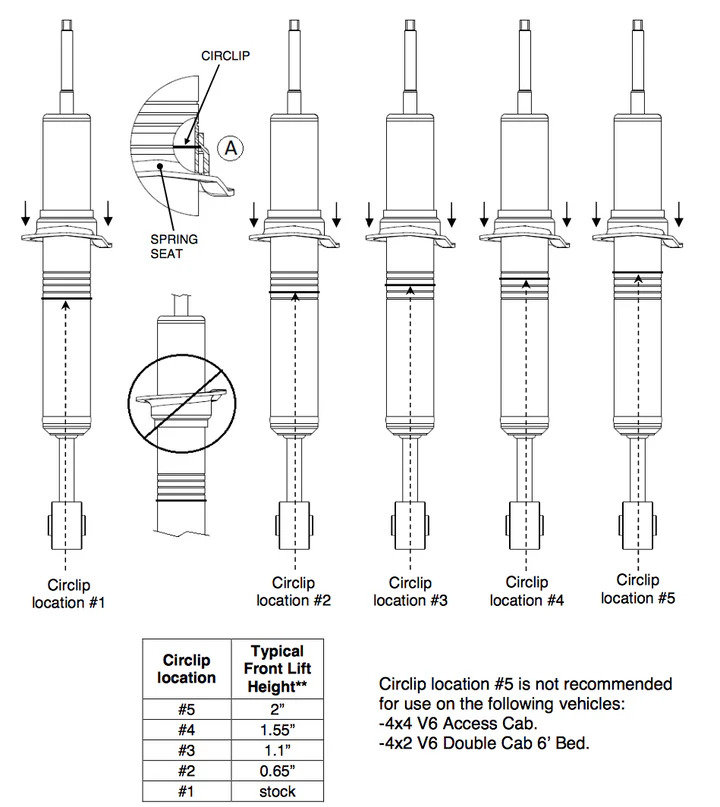

    Hey J, not sure if you have the double cab or access cab, but keep this in mind, regarding the 4th & 5th clip. See below.
    (I have the double cab 5ft box, so I was able to use the 2" top clip, and absolutely love it).

    Yep, I seen that right after I started looking around at lifts. Didn't know that the 5100's existed up to that. Mine's a double cab, short box.

    1st nice thing you'll notice is getting rid of the oem Brake dive. These are a bigger wider shock than the oem Bilsteins, so the ride will remain smooth @ 2".
    Mine sits perfectly level with 33" tires and a 1" block in the rear. (I don't carry anything heavy in the back, hence the block).
