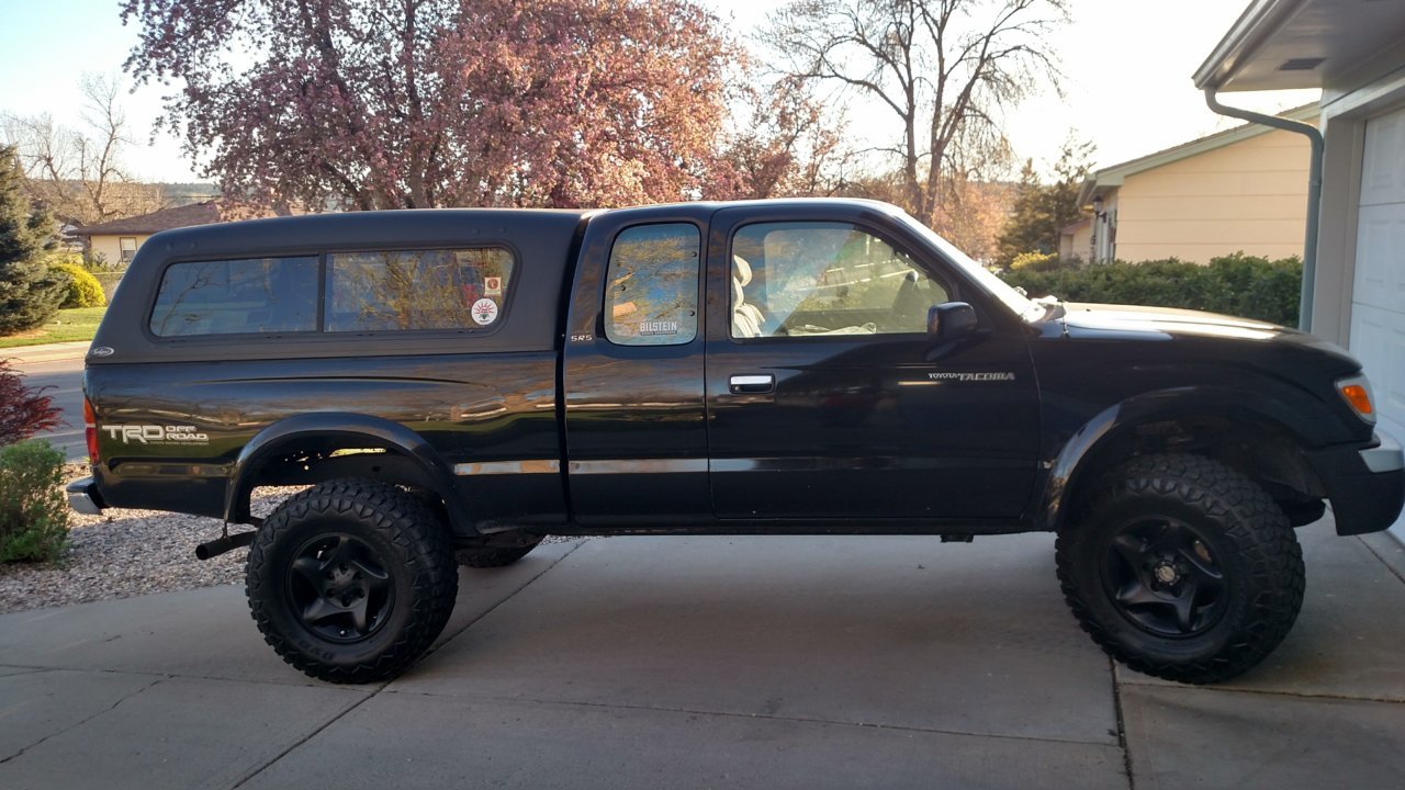

    Hi all! I bought a 2004 Tacoma a few months ago and it came with extra leaves in the rear (presumably for increased towing capacity?) but the front end was not leveled so the whole thing angles down toward the front. It drives me nuts and now I'm trying to decide if I should take the rear leaves out or lift/level the front end to match? I'm not planning to DIY it and my mechanic said it would probably cost about the same for either option so I'm not sure what the best route is.
    For context, I do intend to take it off road in New England quite a bit for accessing remote camping and fishing spots, but it's also my daily driver.
    What would you do if this was your truck?
    ZJNb8uSyXhVOhUE4CbseUr9_H-DHAQGQNjwAmsBL_897d9435db4a60d35dd5242f4ad119171c2a8de4.jpg

    I would assess the leaf pack, and see if it requires replacement.
    If so, General Springs. If not, remove an overload leaf or two.
    I'd also replace the front and rear shocks with Bilstein 4600's, not to mention the front coils. I bet they're long overdo for replacement.
    These trucks in stock form are more capable than the people driving it so even your "remote camping" spots won't be trouble for a stock truck.

    I’d leave it as it is.

    I would 100% lift the front and leave the rear.

    Those rear leaf springs do not appear to be stock, if they’re good, leave em, lift the front, but do a proper lift, no lifting spacers. Working on these trucks is pretty easy with common tools.

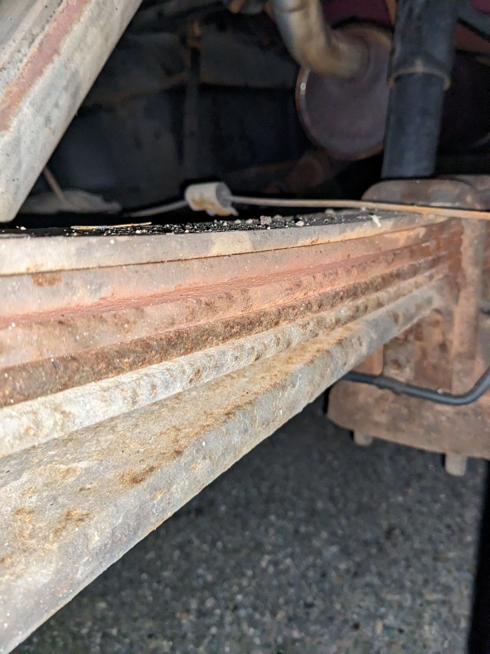

    With regard to assessing the condition of the leaf packs, what are some red flags I should be looking for? Or conversely, how would I know if they're good to go?

    Check for cracked or broken leafs, are they sagging, frown, if none of these they should be good to go.

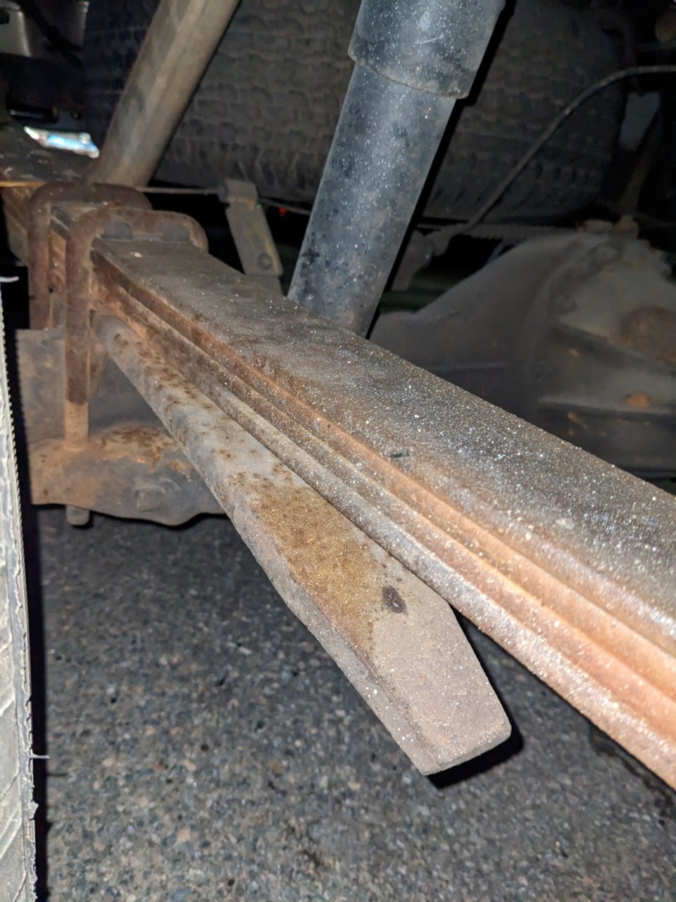

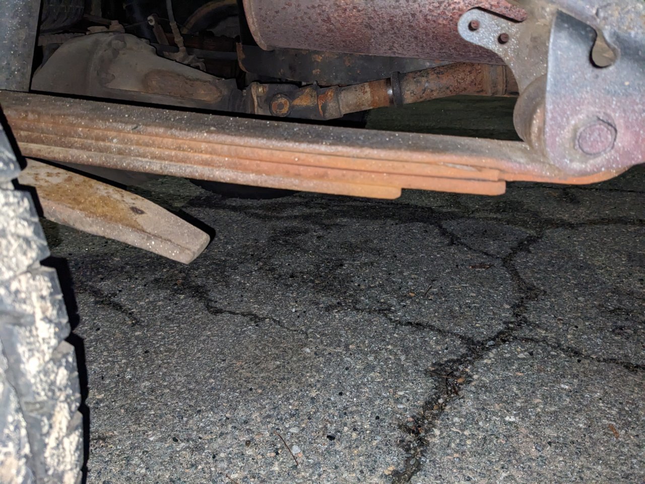

    It looks like you've got upgraded springs, so I doubt you have a block lift... but if you do see blocks between the leaf springs and the axle, then the easy choice is to remove those.
    Not a Tacoma axle, but close enough.

    OP post more pics of the rear leaf springs

    PXL_20230105_002448060.jpg PXL_20230105_002514098.jpg PXL_20230105_002631066.jpg
    I hope this helps. It's nighttime here and the truck is parked on the street so angles are kinda limited. I can try again tomorrow.
