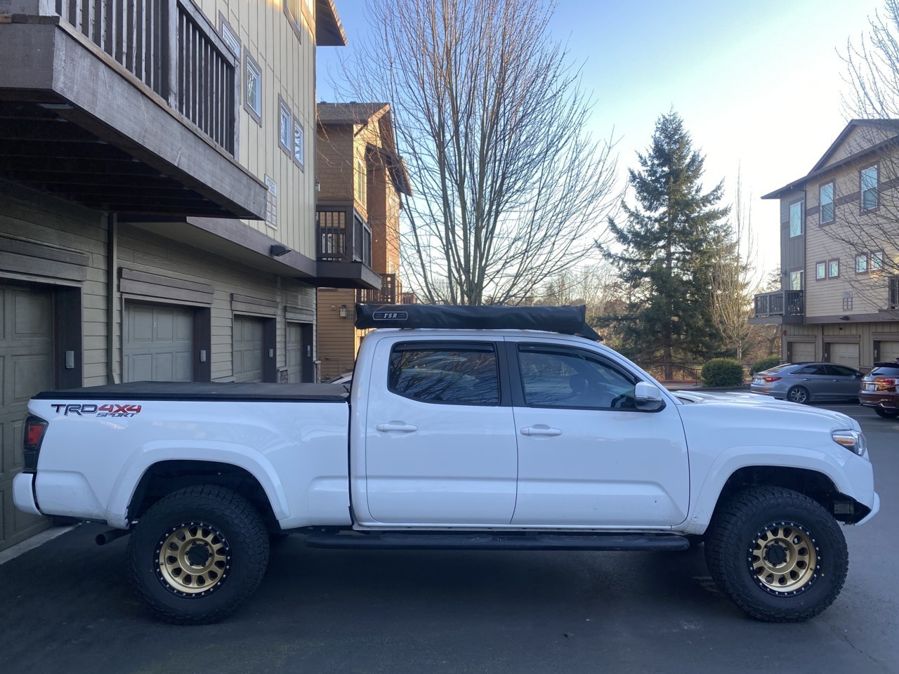

    Do you know what setting you will be putting the 5100’s on? I would go with an offset of either 1 or -12, helps clear the tires from rubbing on the upper control arms. Especially since you want to run 33” tires. You will most likely need a cab mount chop. 5100s can get you a 2” lift at the max setting but they only recommend it for 4x4 V6 double cab long bed models. I’m sure you will need to set at the max setting for the 33s to “fit” but you will have some rubbing.
    Just to give you an idea, I’m running 17x9 -12 wheels with a 32” tire and I was rubbing on some plastic but I trimmed and I no longer rub. I’m also running 5100s front and rear but on 4th setting which is 1.55” of lift and I’m also running a 1” block in the rear.
    There is tons of information on this topic within this forum already, especially for 285/70R17 and bilstein 5100s
    Here’s what mine looks like but keep in mind, I’m only running 32” tires
    Edit: I also recommend you grab a set of wheels that have a 4.5” backspacing for more clearance

    So those are 265s? I would have guessed 285s
  8. Feb 13, 2021 at 3:57 PM
    AdventureTaquito
    AdventureTaquito Well-Known Member
    Jul 30, 2020
    #336084
    183
    Jose
    20' TRD Sport 4x4 DCLB
    No, they’re 275/70R17, 32s

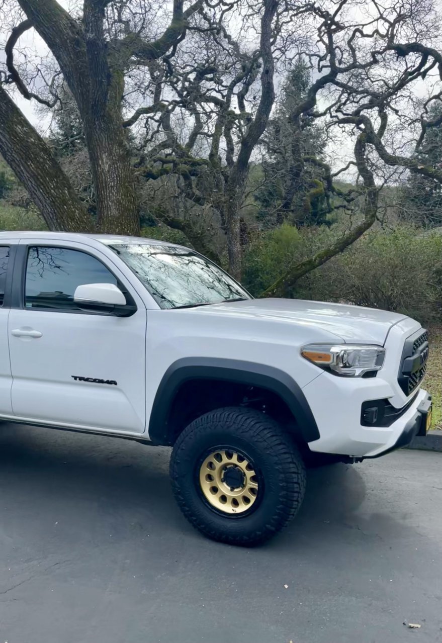

  9. Feb 13, 2021 at 5:40 PM
    71tattooguy
    71tattooguy Well-Known Member
    Dec 19, 2018
    #276275
    5,879
    Dino
    Petaluma , Ca (707)
    2019 DCLB TRD OFF- ROAD
    Kings 2.5” front and rears from Accutune / ICON RXT LEAF PACK black badges doors and tailgate / method 315 / 255/85/16 Yokohama G003 / magnaflow exhaust , axle dump / meso int delete kit / meso led map lights / dome lights / wheelers front super bumps / accutune Flip kit with spacer and new bumps / Cali raised fog light pods / Cali raised ditch lights / RCI FULL SKIDS / SLIDERS / RCI rear bumper / rigid backup lights / tuned on 4.88’s
    these are my 265/75/16 for comparison. For me I’m good. 275’s look HUGE!! Looks good bro :thumbsup:
