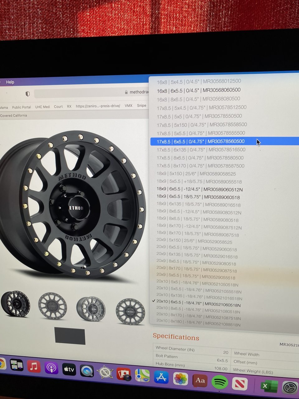

    17in method 305s at the offset of 17x8.5/6x5/0/4.75 (I want to stay with a 17in wheel)
    Let me know if you see any problems with that setup. Thanks fellas

    Gotcha! Will the 17x8.5 wheel fit with a 265 tire?

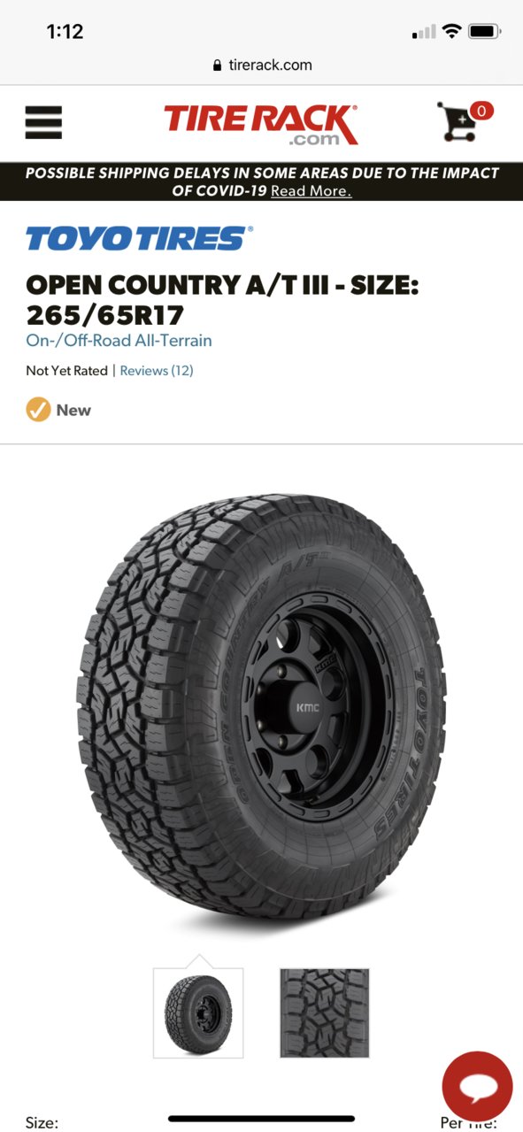

    Awesome. I guess im gonna run a 265/65R17 with a 17x8.5/6x5/0/4.75 wheel. Sound good to everyone? Want it to look good too... Just don't want any rubbing, don't wanna cut anything nor my mpg to go to shit haha

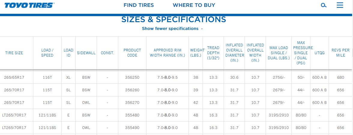

    here are the Toyos in all the different pertinent sizes/plys/load rating, etc.

    C load duratracs in 265/75 only weigh 45 lb each so I would say that is your best bet for not rubbing and keeping decent mpg

    If you get E rated tires of any size your MPG is gonna rapidly decline.
