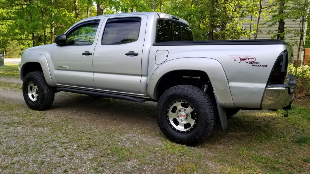

    Front: Bilstein 5100, OME 885 springs, SPC UCA's
    Rear: Bilstein 5160, Dakar Medium Duty leafs
    Price: just under $2k (I did in stages wuth blocks in back originally)
    Tires: Falken Wildpeak AT3w 265/75/16
    I like these tires so much I just bought another set of 4 from Discount Tire Direct for $525 shipped to my door.
    I second the recommendation for Wheelers Off Road. I got great customer service from them when they accidentally sent me an incorrect part.

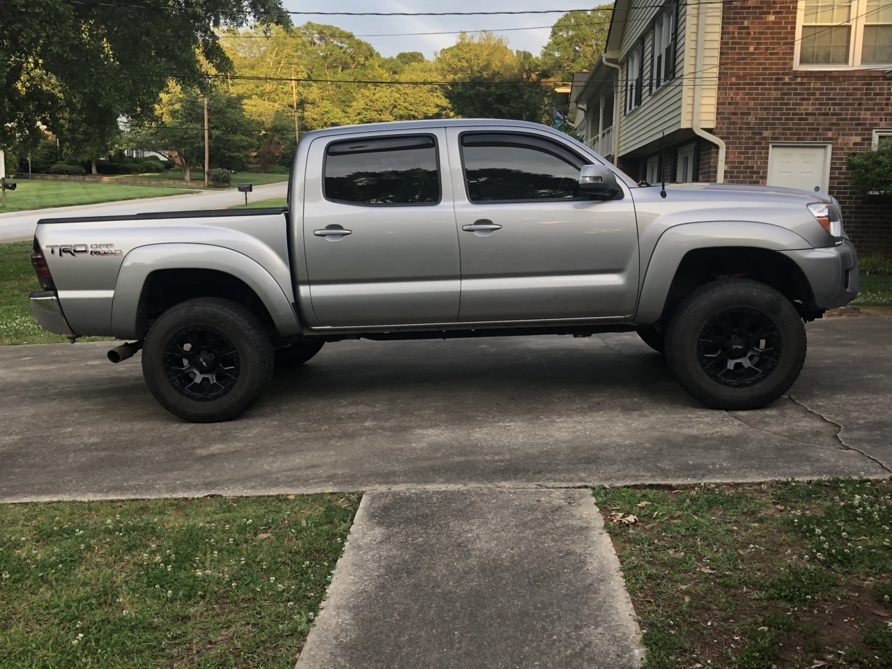

    2015 Tacoma trd
    Bilstein 5100s
    3” ome/Bilstien lift. 265s on 17x9 wheels. Looks going in my opinion and rides good

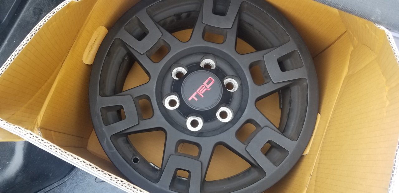

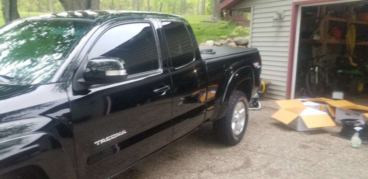

    Threw some tint on "Black Betty" earlier this week, picked up some TRD sema wheels, and ordered some Falken Wildpeaks (265 70 17). Should have it put together Thursday. Now I need to figure out the lift set up.

    I really like the wheel choice. Which Wildpeaks did you get? SL or E? AT3W or MT? I recently researched and purchased AT3W SL rated and have been VERY pleased with them in every way(replaced Toyo AT2). Awesome tire with awesome wet weather traction.
    As far as lift goes, this is different for different people. My truck is 1st gen so I cannot offer specific component advise, but IMO 1-2" of lift makes a substantial difference. Since you referenced low price range, I'd say 5100's up front and AAL. I used Dodge Dakota rear leafs for my AAL and they work fantastic($40) from junk yard(you'll have to research when will work for your truck). I did have to pull the leaf packs myself.
    Good luck, be safe. I'm looking forward to seeing those wheels on there. ;)

    I am going with AT3W SL rated. I don't have any added weight right now and from what I've read the E rated are a bit overkill. I'll only do light offroading from time to time.
    Top I want to spend on a lift is about $1,000. About a month ago someone on CL some recall leads for sell (the replacenents).. wish I had known they'd swap in to mine.
    I'll get a pic up as soon as the wheels/tires are swapped. I'm definitely excited and also plan to remove badges. I know black everything has been done but she looks damn good cleaned up.
