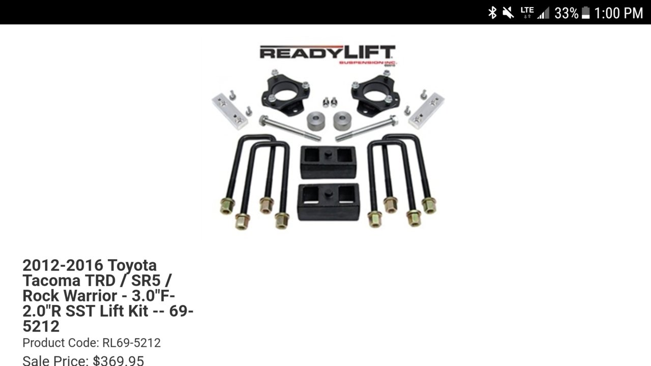

    Been reading a bit and not able to find exactly what I'm looking for.
    Currently running a ReadyLift system, which was dealer installed when I bought the truck . Having no issues but I just want to make a slight upgrade to the actual suspension.
    I drive on the road 95% of the time, and the only "offroad" I do is loging roads to go hunting. The most weight I carry in the bed is a dirt bike.
    So would I be able to just simply swap out the rears keeping the blocks for the lift. And for the front, put in 5100s with the 2.5" preset notch, stock springs and forget about the spacer? Leaving the dif droppers and sway bar attachments?
    Currently running 275/70/R17 as well.

    Trucks gonna ride rough as hell with the spacers and 5100s set at 2.5”. I wouldn’t do it.

    If you pull the front spacers and ise just the 5100s for front lift it will work, you also can leave the blocks and add 5100s in the rear. If i May suggest though, you can swap the blocks out for and add a leaf for like 100$ and it will be a much better overall lift kit

    There are 3 ways I am thinking about going for suspension upgrades increasing in cost...:p:
    1. 5100s all around w/ 887s keeping the rear 2" blocks
    2. 5100s all around w/ 887s with Tough Country 85255 AAL (adding 2")
    3. Or the full OMETAC16LKSB
    2 Questions regarding the possible upgrades:
    1. Should I keep the Diff spacers and sway bar extenders installed from the ReadyLift regardless of which route I choose?
    2. Would I also need to buy new leaf spring clips if I run the AAL or will the stock ones work?
    Thanks for any advice!!!

    AAL will probably ride better than blocks. I'd go with new leaf packs if you can afford it. You get what ypu pay for, just don't go with blocks, you'll regret it down the line.

    Go all in! Diff drop does very little to improve drive axle angles on 2nd and 3rd gens. Won't really hurt tho unless you go with aftermarket skids.
