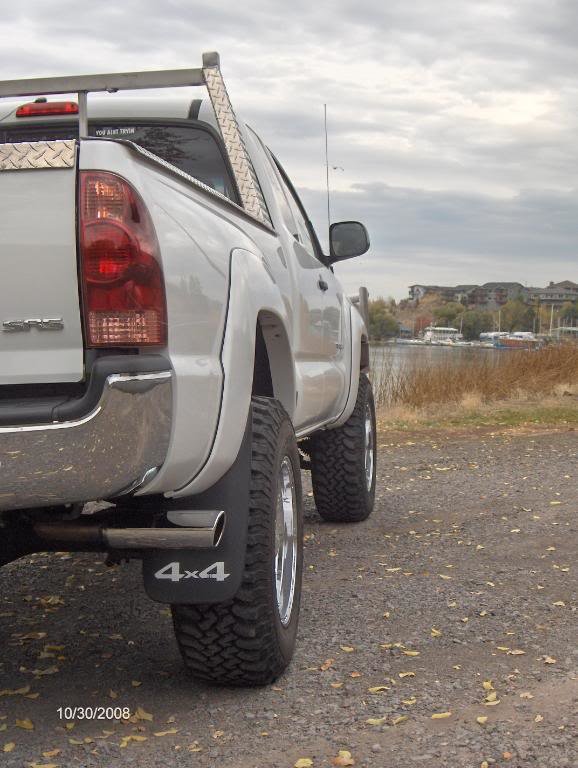

    my wheels have the same specs as the one i posted the link to. heres how it looks:
    im running a narrow 255 tire' i think a wider 285 or even a 305 will stick out a little farther and look tougher like you want.

    xtreme450, great posts. I am running the BFG M/T in 285, by looking at your pic's mine only stick out a little more than yours. Just enough to give a rooster tail on the sides when driving straight.
    What pressure you running?

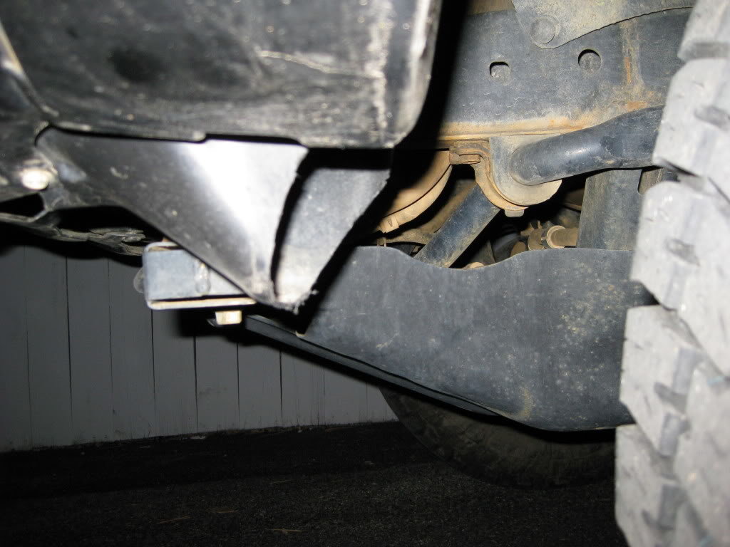

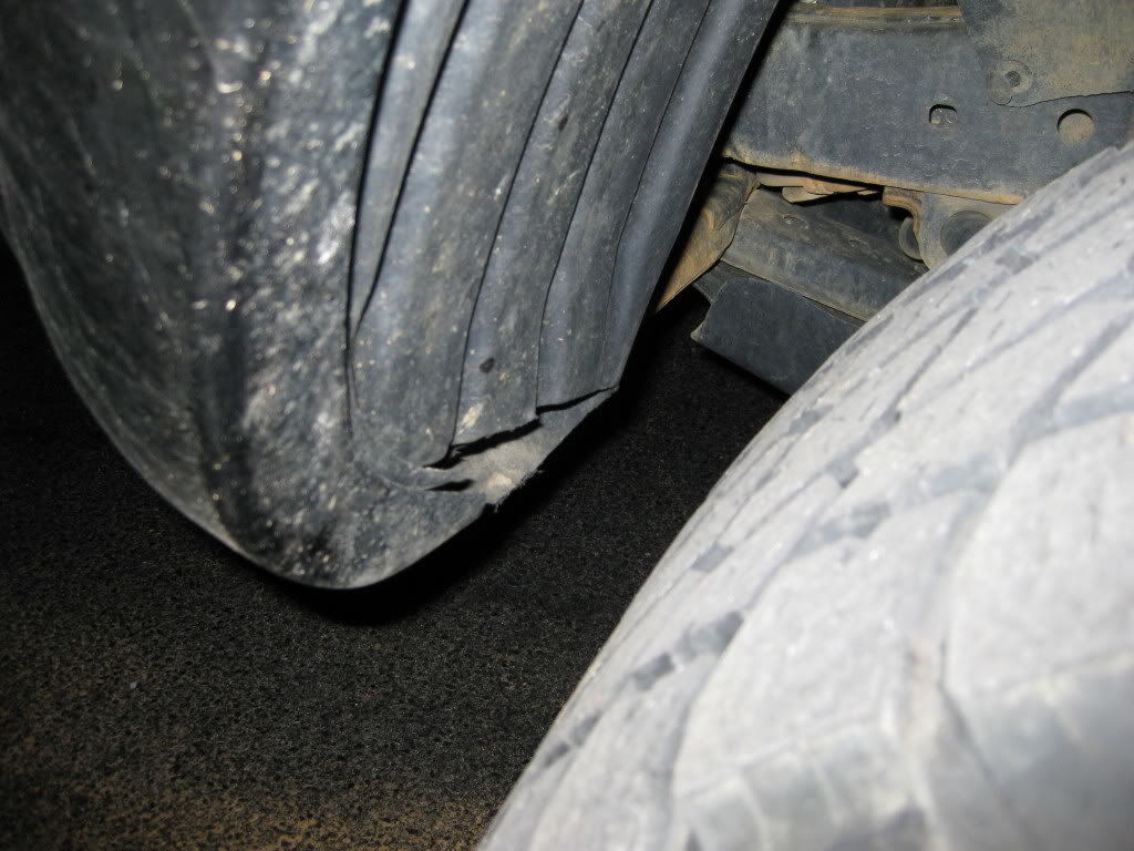

    Minor trimming for stock wheels with spidertrax and 285/70/17 tires
    From the front you cant tell its been trimmed.
