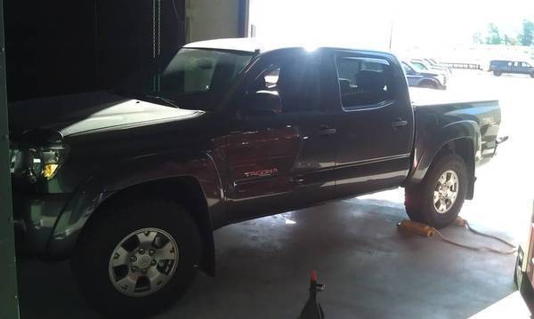

    here's mine, when i had the billies on it...2 1/2" lift with 265/75/17's.
    and for the boom boom, depending on your price range..jl stealthbox is a great product...2 10's.

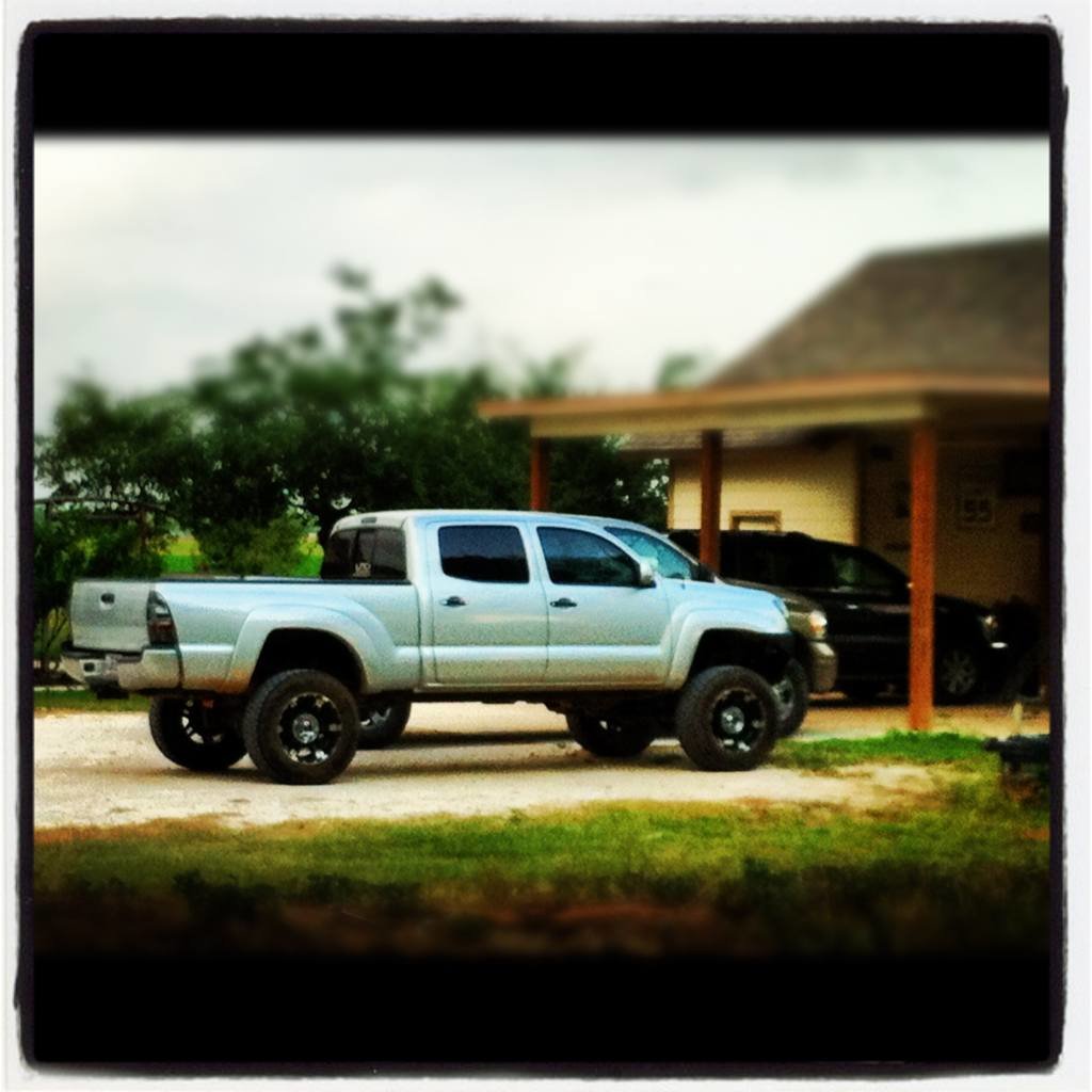

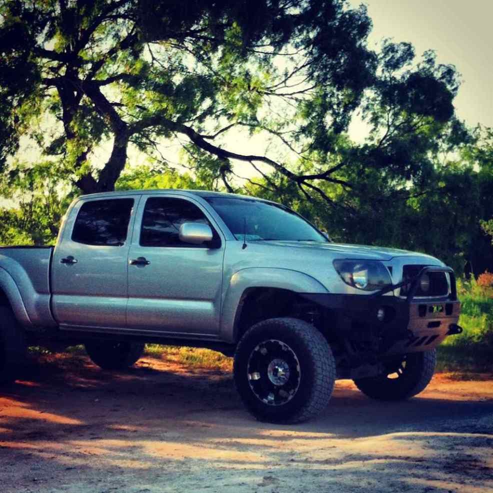

    I could be mistaken, but I dont think there are 4 in lifts for the tacoma... And for gas mileage, The big factor is larger tires. Granted a 6 in lifted truck is also going to catch more wind than a 3 in lifted truck. The wind drag is not as big a factor as how much rubber your engine has to turn.
    Mine is lifted 3 inches with 265/75/16 tires on it. average MPG is usually around 16-17. But that is also with about 300 ish extra punds of steel armor on top of the lift and tires.
    Given that you only have a two wheel drive, I assume (which I know can be dangerous) that you don't intend to do much off road driving which is what the quads are for I suppose, so I would recommend doing a simple spacer/ add a leaf 3 in lift. Not going to change much but ride height and you dont really need a fancy suspension. Plus at 6 inches of lift towing a smaller trailer can be kind of a pain without a decent drop hitch.
    Here is a few pictures of mine, if you want to know the mods click on the signature pic for my build thread, or just ask if you have a specific question. The lift is an Icon Stage 2 + their tubular UCAs. Tires are 265/75/16 Goodyear Wrangler Duratracs.
    and here it is before the armor, so you can see stock height
    [​IMG][​IMG]
    V.S. lifted, but the front was only at 2.5 at this time.
    Oh yeah, and Welcome to TW! Hide your money now before it is too late. If you are on this site for long your money will likely start to disappear and reappear as stuff on/in your truck...
