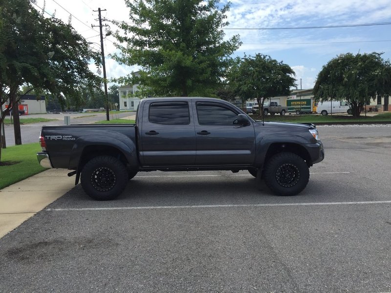

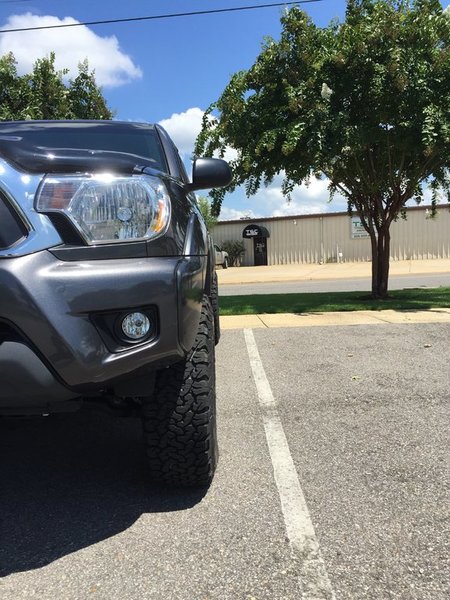

    This is how I current sit. I may just bite the bullet and order them. Don't like the idea of cutting up a new truck. image.jpg

    Well.... I wouldn't buy the 285's if you aren't ready to cut a bit of that front fender....

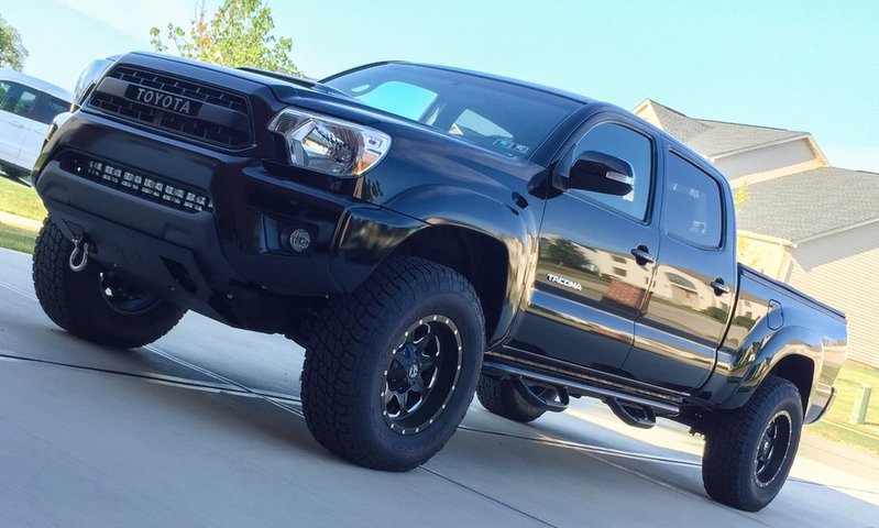

  14. Aug 22, 2015 at 7:56 PM
    #34
    Nimbostratus
    Nimbostratus Well-Known Member
    Jul 12, 2015
    #159333
    749
    Tuscaloosa, AL
    2019 Toyota Tacoma TRD-OFFROAD
    I haven't honestly but may look into it. When I got my truck allignement they said that every was good and they had plenty of room to work with. Not sure exactly what that means but it drives great. No pull at all.
  15. Aug 22, 2015 at 7:58 PM
    #35
    Nimbostratus
    Jul 12, 2015
    #159333
    749
    Tuscaloosa, AL
    Are you running a three inch lift also?
  16. Aug 23, 2015 at 4:15 AM
    #36
    Pgh Tacoma
    Pgh Tacoma Well-Known Member
    Jul 8, 2015
    #159015
    69
    Pittsburgh
    2015 Black DCLB TRDSport 4x4
    3"/1" Lift Level 17/9/-12 Fuel Boost 285/70/17 Nitto Terra Grappler G2's BedRug TonnoPro TRD Grille Stub Antenna Heiss 30" Dual LED w/ OEM Cab Switch
    I am.
