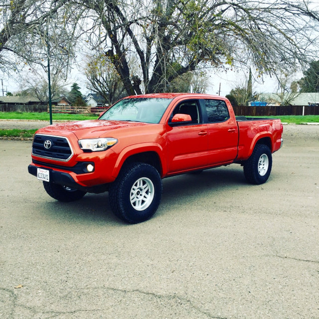

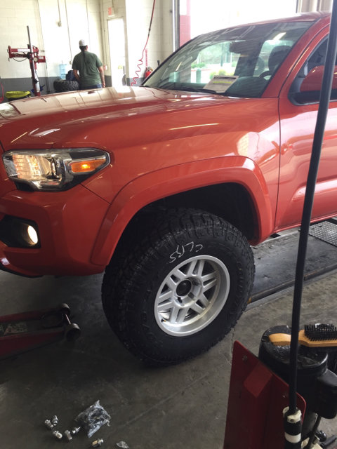

    2 inch lift and tires
    Here is my setup
    Dclb inferno
    2 1/2" day star level with 1" block in rear
    Toyo at 275/75/17 like 34" the only tire I will ever run, I had them on my last tacoma on my last f-250 on my dads truck and many trucks before never can find a better tire that last like these and have awesome grip off-road
    With scs 6 wheels love them had them on my last truck and the only reason I went with such a big tire is because when they do make fenders this truck will be all long travel just like my last one so I didn't want to put a small tire
    Be in mind with this set up I had to do the cab mount chop which isn't hard, and some plastic cutting I still rub when going over bum a fast while turning but I'm not going to cut my fenders and ruin them, also keep in mind that your fuel will suffer bad I went from 18/19-10/11 and when I go 70mph or higher I can't keep it going in 5th gear it just looses speed and has to down shift to 4th but I will soon be doing gears, and locker in rear. Have fun with your search this is only my set up for right now until I have the parts available to finish9fb4637dad6fe64db50064179165bb7a_5fc463f8ae576919301cc371a44ae2ab89b659c0.jpg0e8bd9b4904a93a1a3f8111915bd42a2_b867db665ebedacb254e4ebc1a3bc3d29c522023.jpg
